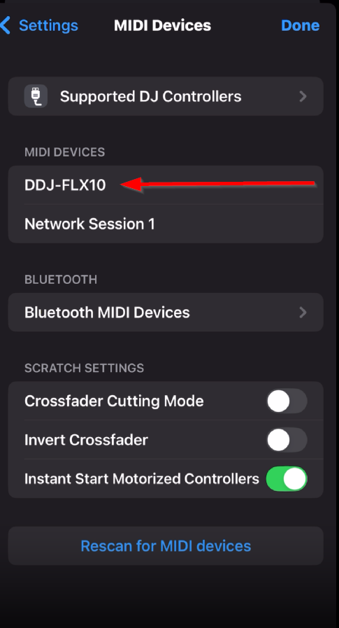

Video here buddy
Thanks @Dysfunk_DJ, I’ve passed this onto engineering.

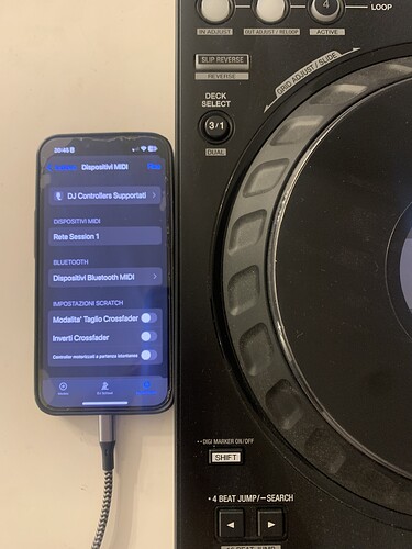

I don’t see any console. I think it’s a cable problem but they’re the same cables I used with the Mixon 8 and they worked.

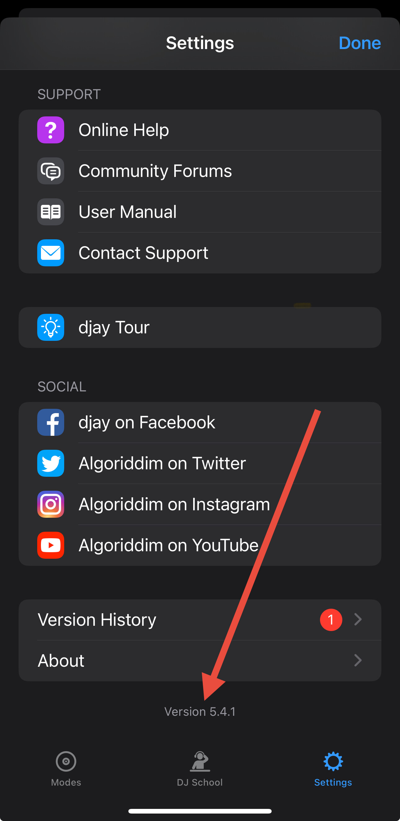

Hi again @Dysfunk_DJ, can you please confirm that you are running djay 5.4.1 and not 5.4?

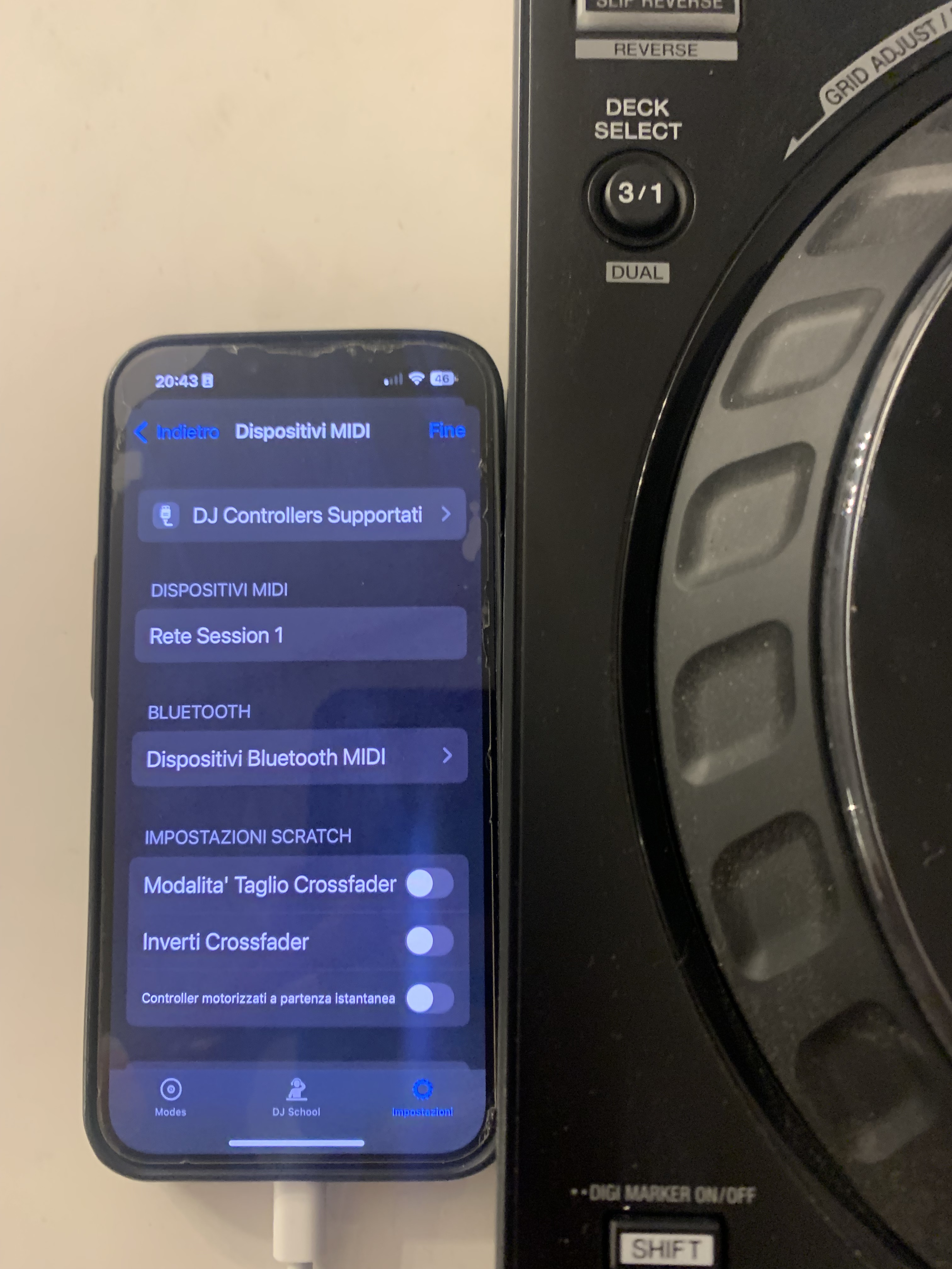

Hi again @Randal, can you please share a screenshot or short screen recording like Dysfunk shared above of your djay Settings>MIDI Devices page with your FLX10 connected to your iPhone 14 and powered on?
Can you please also try using a different USB-C to Lightning cable to connect your iPhone 14 to the FLX10?

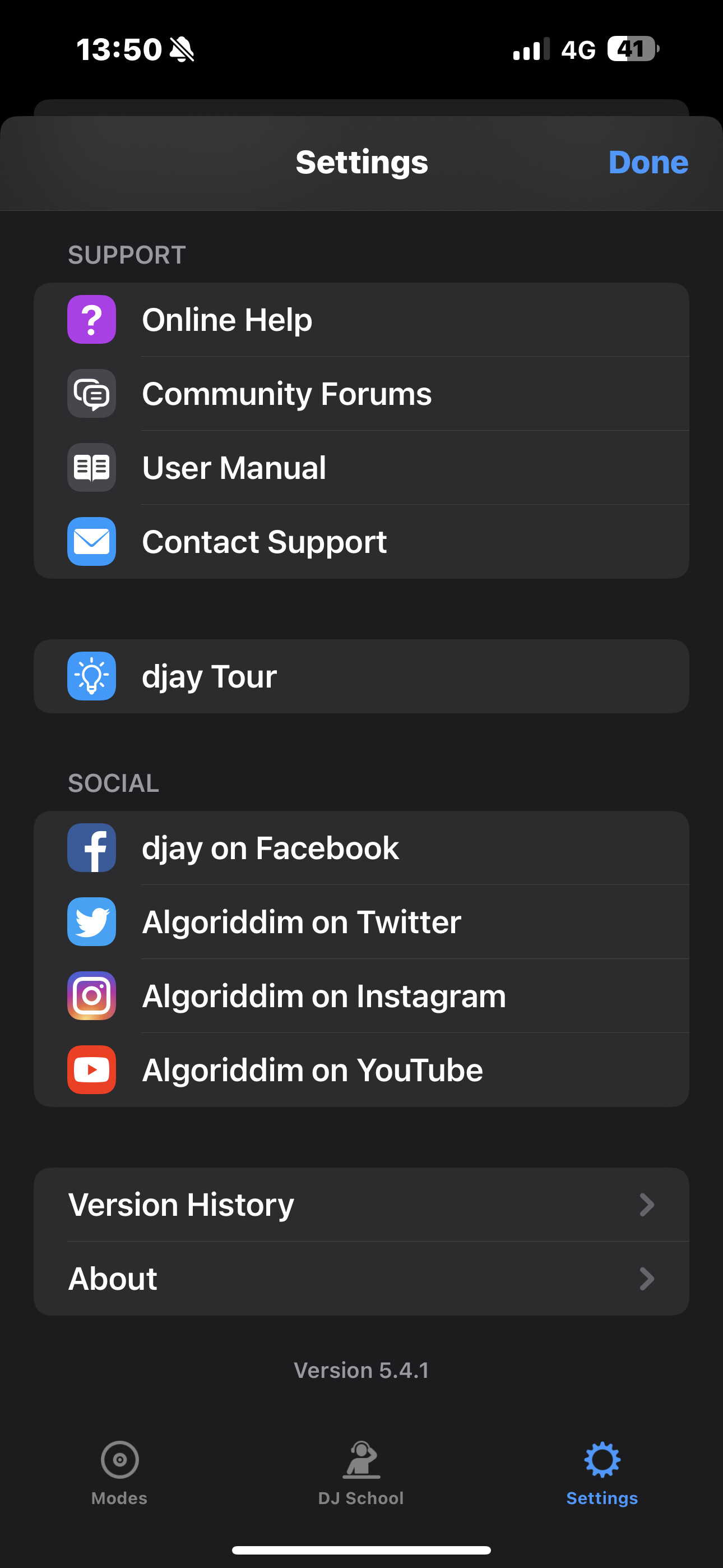

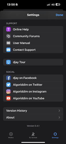

Interestingly version number is 5.4 ?
@Dysfunk_DJ please share a screenshot of the bottom of you main djay Settings page.
Thanks for confirming @Dysfunk_DJ

Hi @Randal, thanks for the photos - this is very helpful. Based on these, your issue appears to be different as the DDJ-FLX10 is not showing up at all in the MIDI DEVICES section like it is for Dysfunk_DJ.
This leads me to suspect that it is a connection issue. First, please check the Lightning socket of your iPhone to ensure that it is free of dust/debris. I personally have experienced connection issues with iPhones due to pocket lint - believe it or not. Then, please try the procedure below.

Also, regarding 5.4.1 still not working with the FLX10, can you please confirm that you are not using the TestFlight beta version, but the 5.4.1 version from the App Store? Thanks.
