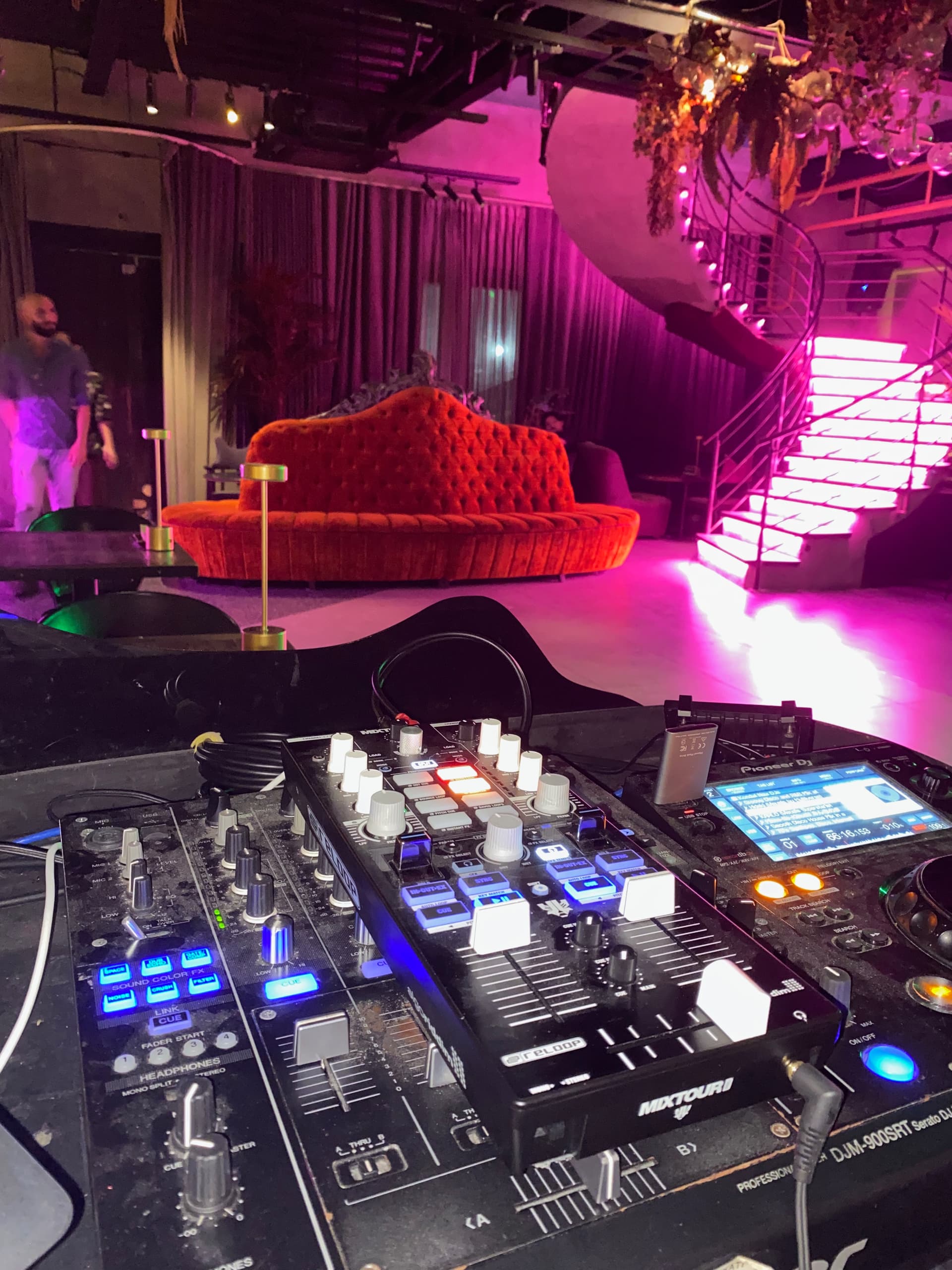

Here’s the setup. Mixtour Pro on top of the Pioneer DJM-900SRT (plugged into channel 1). I like the matching blue lights. Notice the fat USB stick plugged into the XDJ as backup.
I have DJ’d this venue with both XDJs plugged into a MacBook and it worked, but this simpler rig works just as well and is faster to setup and breakdown.

That’s useful. Thanks. I see no MacBook/ iOS device is that just out of shot or am I missing something?
I have a Mixtour pro and I played connected to Club grear before, but I wouldn’t of thought the MTP could be sat on top like this. Doesn’t it move around whilst your playing? I usually get quiet wild on the line faders and effects.
(Off-screen) I have an iPad on a mic stand + Hercules DG307B Tablet Holder.
I set the hardware faders to Thru, pull them down and seat the Mixtour Pro rubber feet solidly on the knobs/faders. It’s pretty solid. Deck space is the main problem at this venue. I can partially move the left XDJ, but it’s still very tight.
