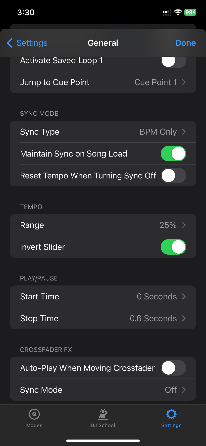

I suspect this has to do with your djay settings. Can you please share a short screen recording from how your Sync in Serato behaves? Also, please share some screenshots of the djay Settings>General>SYNC MODE?

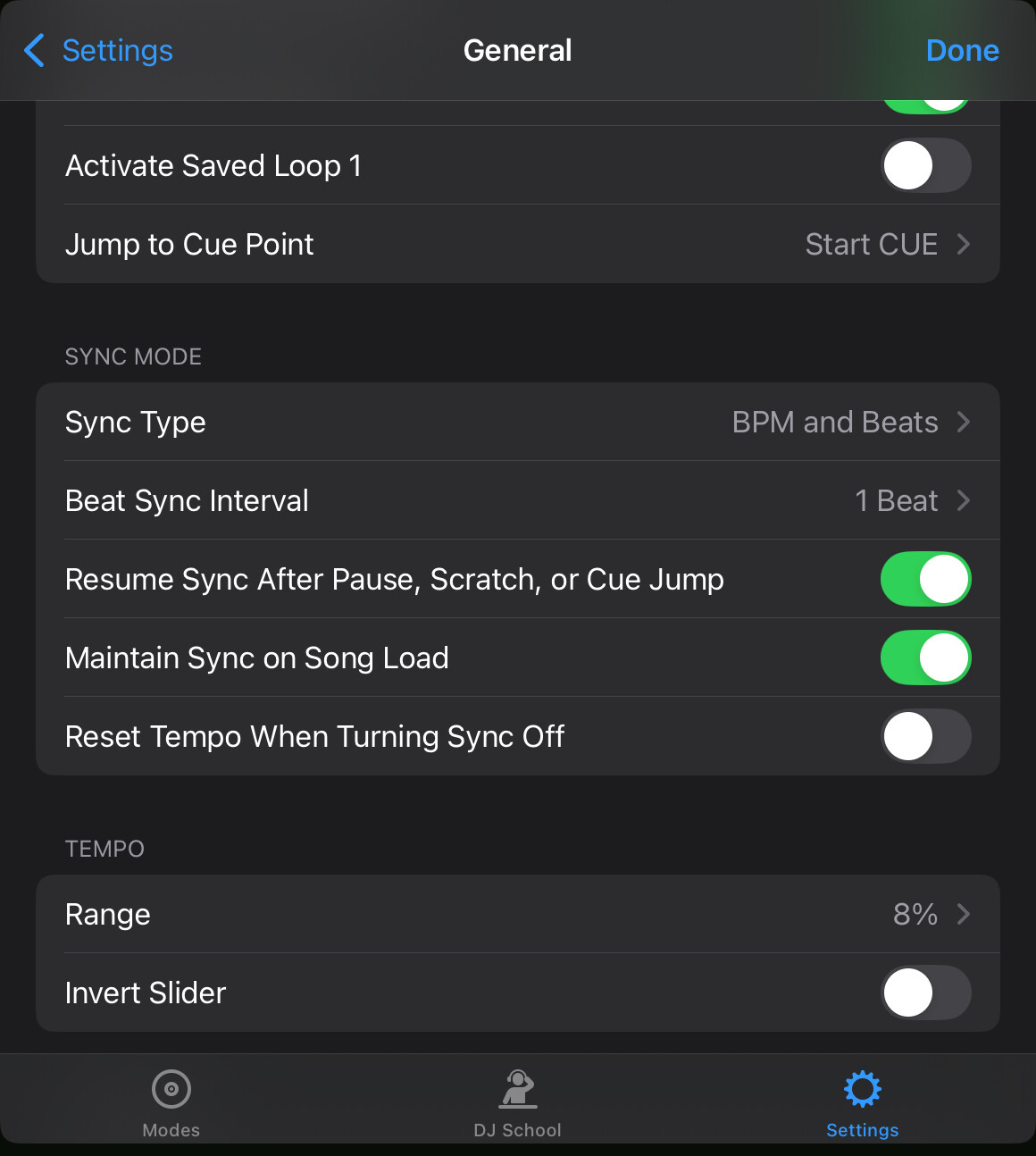

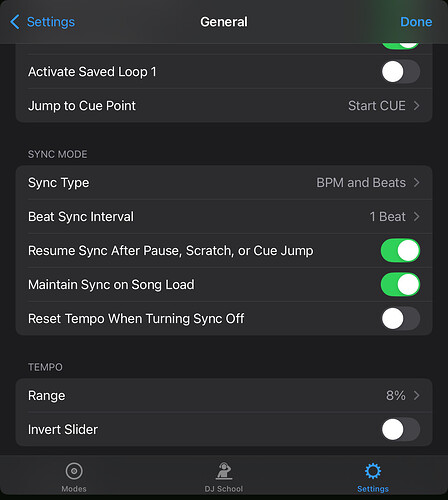

Hello please im sorry regarding the sync issue i would like to clarify what i wanted to say because in serato dj when you use sync its only sync the bpm and beatgrid only it doesnt affect the tempo slider in the software or the hardware but i wonder when i use bpm only sync in djay pro my tempo slider in the software adjust with the sync i think the sync should only affect the bpm only and not the tempo slider
This is my settings both on iPhone and on MacBook
I hope you understand my complaint with the DJay Pro Sync function
This is currently expected behaviour with djay.
