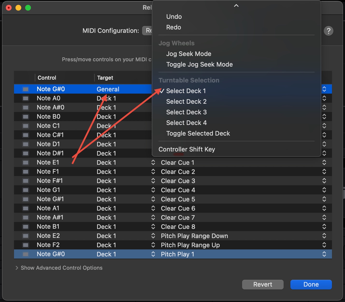

Since I don’t use the crossfader for its original purpose, and because the crossfader in djay -since 5.3 -no longer allows assigning the active deck manually, I’m considering requesting a new MIDI function to manually assign the active deck - overriding the automatically determined one, similar to how it worked before.
Do you think that would be a good direction to take?
Hi @DJ_Big_Blender, there is already a MIDI mappable command for Active Deck selection. I’m not in the office at the moment to check specifically where this command is, but I can check for you later if you can’t find it.
Hi @Slak_Jaw, I’ve searched for this but haven’t been able to find it. It would be great to have that functionality available. Ideally, I’d love to be able to assign it to the crossfader so it can replace the previous behavior, just like it used to. Appreciate your help!
Hi @DJ_Big_Blender, just set the Target to General then scroll down to the Turntable Selection section. Here you should find the MIDI commands you’re looking for. I mapped these to buttons on my hardware. Unless your Crossfader sends separate MIDI commands at either end point, you will need to map this to buttons.
Ok, thanks!
I just tried that.
First of all, I discovered that the ‘Select Deck’ option can no longer be assigned to a fader like it used to. So instead, I assigned it to an available button — but unfortunately, that no longer does the trick either.
My main goal here was to be able to select the example track for the Match functionality, like it worked before. That didn’t work — but are there any other ways to achieve this?
Sorry that didn’t do the trick @DJ_Big_Blender. Sounds like we probably need a new MIDI command or feature then to make this work. Can you please create a new Suggestion topic and clearly explain what you’d like to achieve? Then I’ll pass it onto the devs to see what they think. Thanks!
