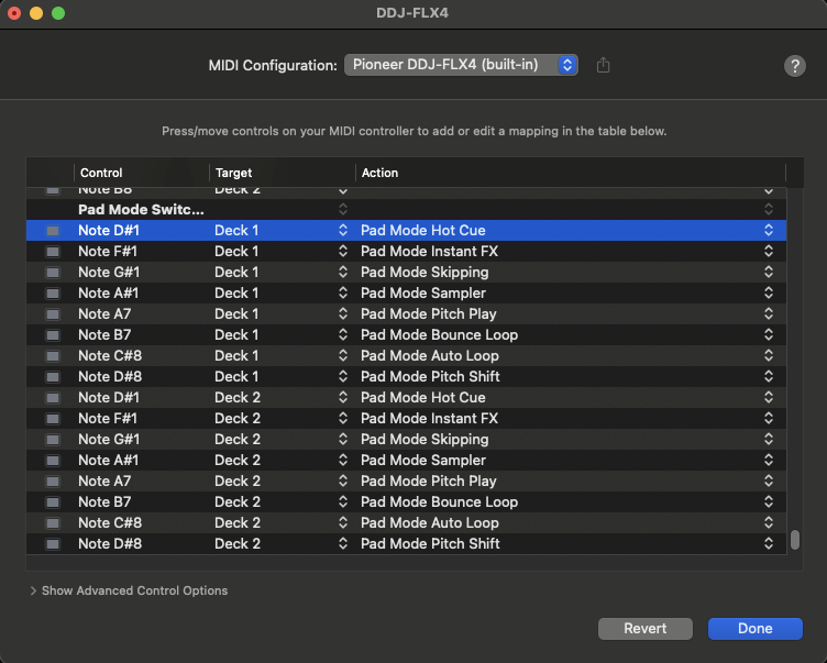

Has anyone else fingured out what ‘Pad Mode Hot Cue’ or any of the others do?
It’s basically same as before, just easier to read. The new MIDI commands switch the functions of the controller Pads as a group. Press Hot Cues and the Pads function as Hot Cues … etc.

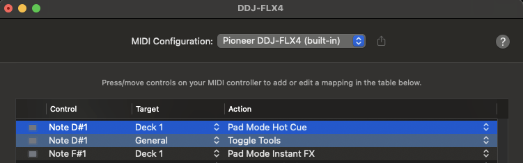

Tools View
Best I could do was duplicate the Mapping for the Control (Note D#1) and have it toggle the “Tools View”. Unfortunately, I still see no way to open a specific screen in the Tools View or just have it open for a single Deck. Notes: Interestingly, the Mixtour Pro reportedly can do something like this, so maybe it’s in the works?
So Mike, on both your Midi mappings, and the stock ‘built in’ mapping, changing the pad mode doesn’t affect anything as, all the pads are still individually mapped to different function.
It sounds like you’re saying that if I map ‘Pad mode hot cue’ for the DDJFX4 pad select your button that says ‘Hot Cue’ I shouldn’t have to map the individual pad buttons (1-8)?
Because when I delete a mapping for pad button, (pad 1 under the hot cue, Note C-1) , my controller doesn’t do anything.
I could see the benefit of mapping pad mode and then you don’t have to program the 8 pads individually, that would be easy to change functions, like adding in slicer without having to redo all of the pads on all the decks.
In fact, if I delete all the functionalities for pads 1-8 and then map ‘Pad Mode Slicer’, it seems sounds like my pad buttons should work with the slicer, but they don;t function. This is on my FLX-4, and my DDJ-1000.

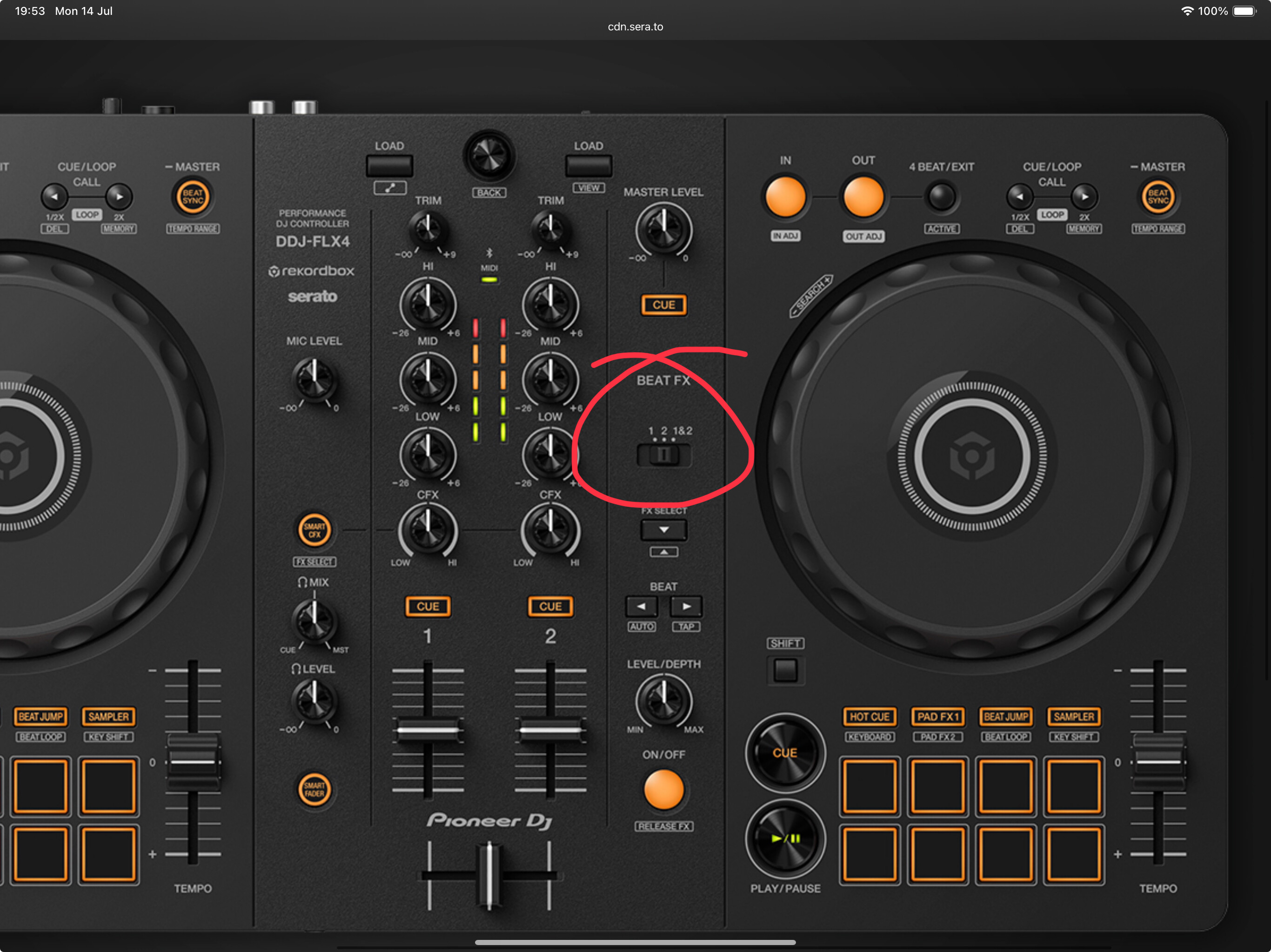

Also, @Michael_Wisniewski while I’ve got you here, I noticed on the stock midi mappings for the FLX-4, algo has figured out a way to select both decks one and two with the beat FX selector switch. I’ve compared the mappings several dozen times using BBEdit, cannot for the life of me figure out what part of the code so I can copy it over. I would redo my mapping, but if it’s not built off of yours, I have limited functionality and I use more than one shift layer at the moment would be ideal if I could just copy that part.
You wouldn’t happen to know what change I can make in the code to select both decks at the time would you?
You still have to map the individual buttons (1-8), by default they are unassigned. The new Mode commands just make it clearer which group of functions are being called up.
For example, in Hot Cue Pad Mode, you still have to individually map each Pad to Hot Cue #1, #2 etc..
There are also new User-Defined Pad Modes, so we can have custom pad mappings without messing up the defaults.
The FLX4 hardware does not send a MIDI command when you Select Both Decks. Whatever signal the hardware sends is captured by the djay software outside of MIDI and is not accessible to us in the mapping.
This is still the case today, and real shame :pensive_face:
@Slak_Jaw might you or your engineering team know how this button works with your official mapping but is unavailable for us to use on a custom mapping?
To confirm, DDJ-FLX4, deck 1 switch position and deck 2 switch positions are both able to be mapped but the third “1&2” position is not (but you somehow have it working in your official map):
Grateful for any insight :blush:
Hi @TheSouthernDJ, this is normally done to ensure proper behaviour of the hardware with djay. Typically when something more complex needs to be done that is not supported by the djay MIDI Learn tool.
If you’re familiar with editing XML files then you might be able to make the desired adjustments via the text file. However, I do not recommend this if you don’t know what you’re doing. If you search around this community, you will find some power users who’ve been modifying these XML files. I hope that helps!
