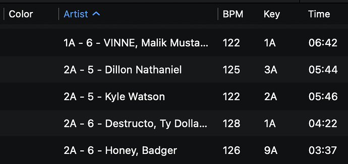

Hi @SpinThis, djay does perform its own key analysis and there currently is not an option to use other metadata for this or to overwrite the djay analyzed key value. I used to use Mixed In Key myself. The work around that I used was to have MIK write the Key and Energy level as a prefix to the Artist Name. Then I could sort the Artist column.

In the meantime, the workaround that I’ve been using for many years is to adjust the Mixed In Key settings to write their analyzed Key and Energy Level as a prefix to the Artist. Then you can sort the Artist Column to sort by MIK Key.
