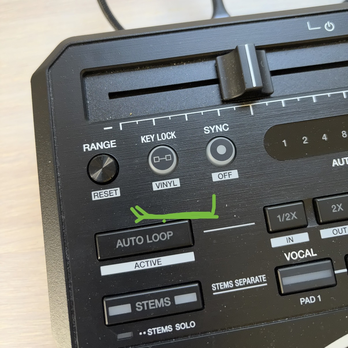

I have a REV5 but can’t test anything rn.
Though, are you sure you are in VINYL mode ?
If I remember correctly, if you want to be in turntable/scratch mode, you have to activate VINYL mode. And if I remember correctly (again), the default mode (Vinyl on/off) is not the same with all DJ software (so you may want to try toggling this).
You may want to toggle that switch (or read about it to check if what I am suggesting makes sense or not). I hope this helps.

I am using “Vinyl Mode.”
