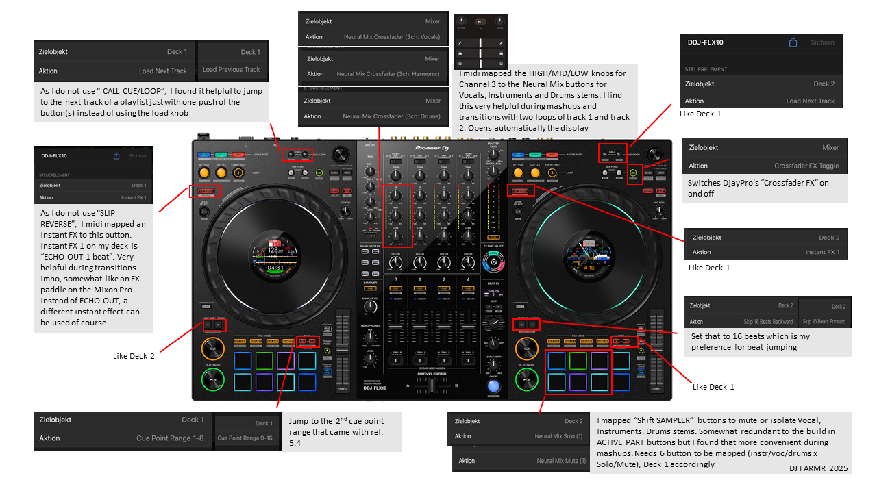

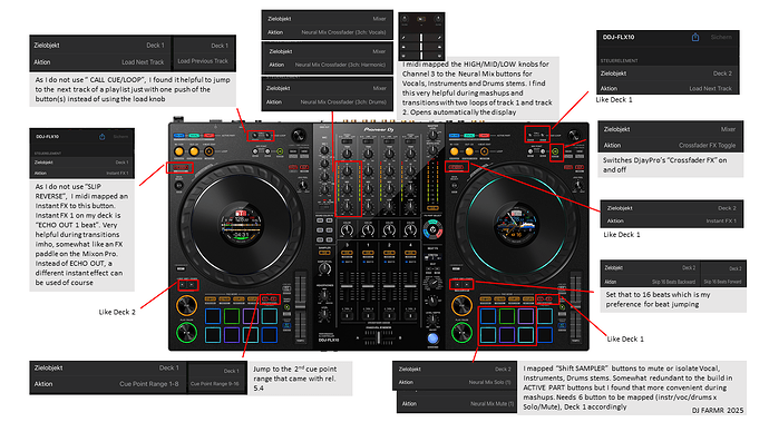

Here is what I did for my DDJ FLX10:

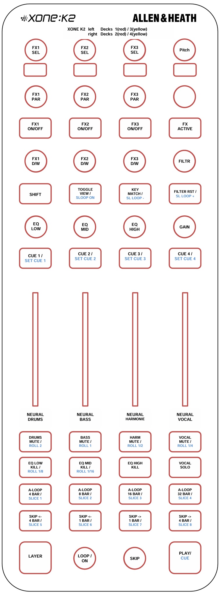

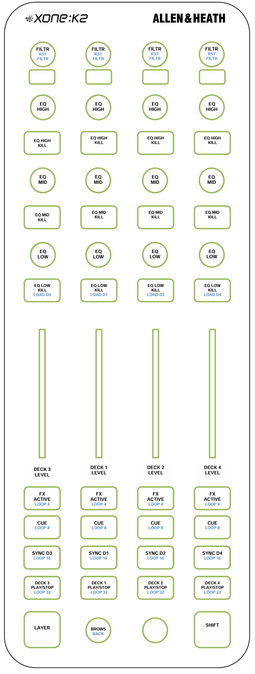

I made a mapping for 2 chained Xone K2 in Latching Layers mode (both set to different midi channels). Left controller is connected to right controller, which is connected to device via USB. Left controller is controlling deck 1 (red), deck 3 (yellow) and 4 channel mixer (green). Right controller is controlling deck 2 (red), deck 4 (yellow) and same mapping for 4 channel mixer (green). I’am using them with Mixtour Pro inbetween. I’ll share the Midi Mapping file tomorrow.

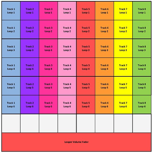

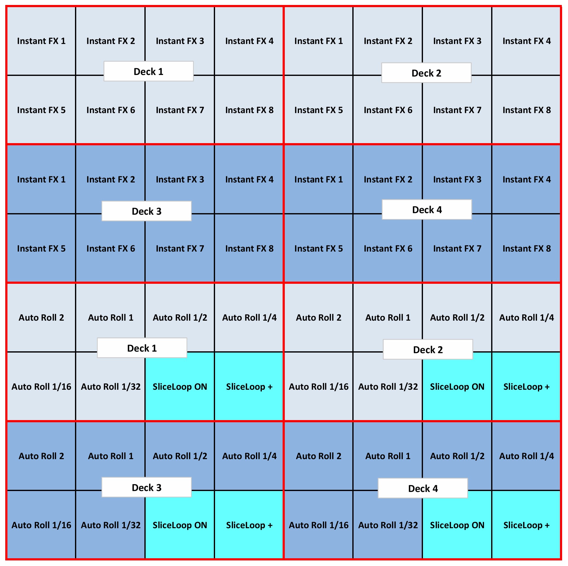

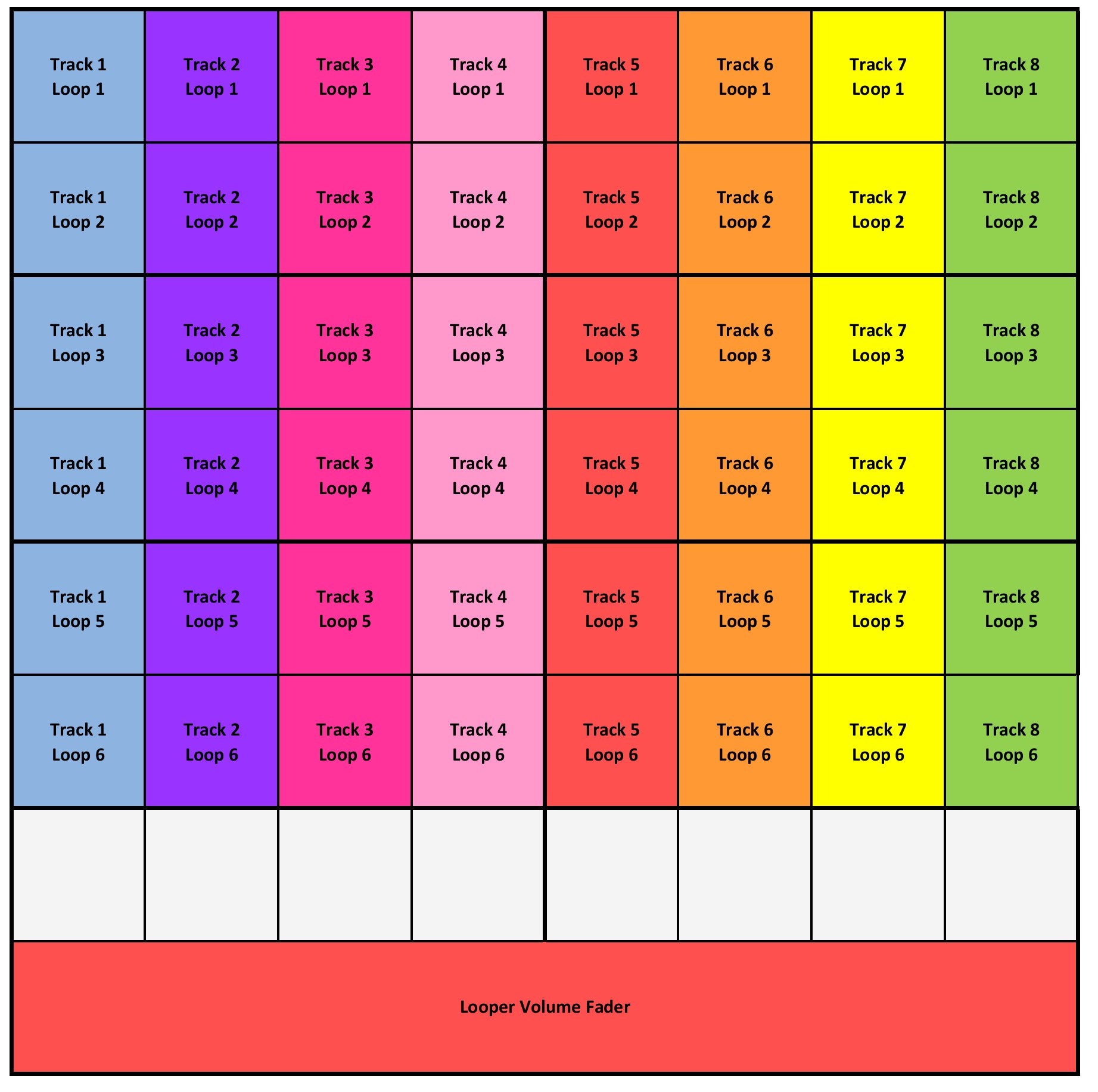

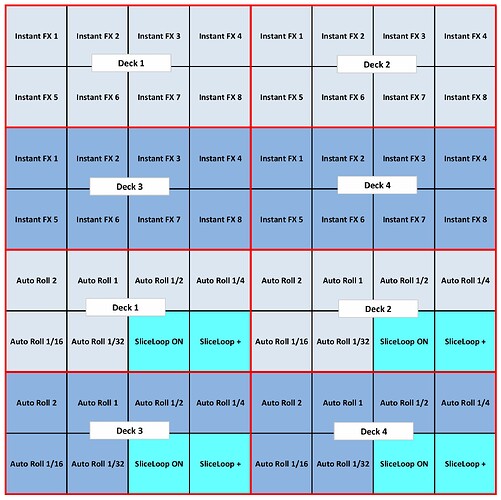

I made another mapping for Novation Launchpad PRO MK3 in Custom Mode. The advantage off coustum mode on Launchpad is, that you can define 8 swichtable pages of the 64 pads. Disadvantage is, that this mode cannot receive LED MIDI Feedback from DJay. Before the mapping in Djay, you have to set up your Launchpad costum mode in Novation components software. There, every costum page get’s its own midi channel and color coding. Pads have to be set up with CC values 1 to 64. Then the mapping should work. Basicly Page 1 is controlling 8 Cues and Saved loops of Decks 1 to 4, Page 2 is controlling Instant FX and Bounce Loops of Decks 1 to 4 and Page 3 is controlling Looper Tracks 1 to 8. I’ll share the Midi Mapping file tomorrow.
