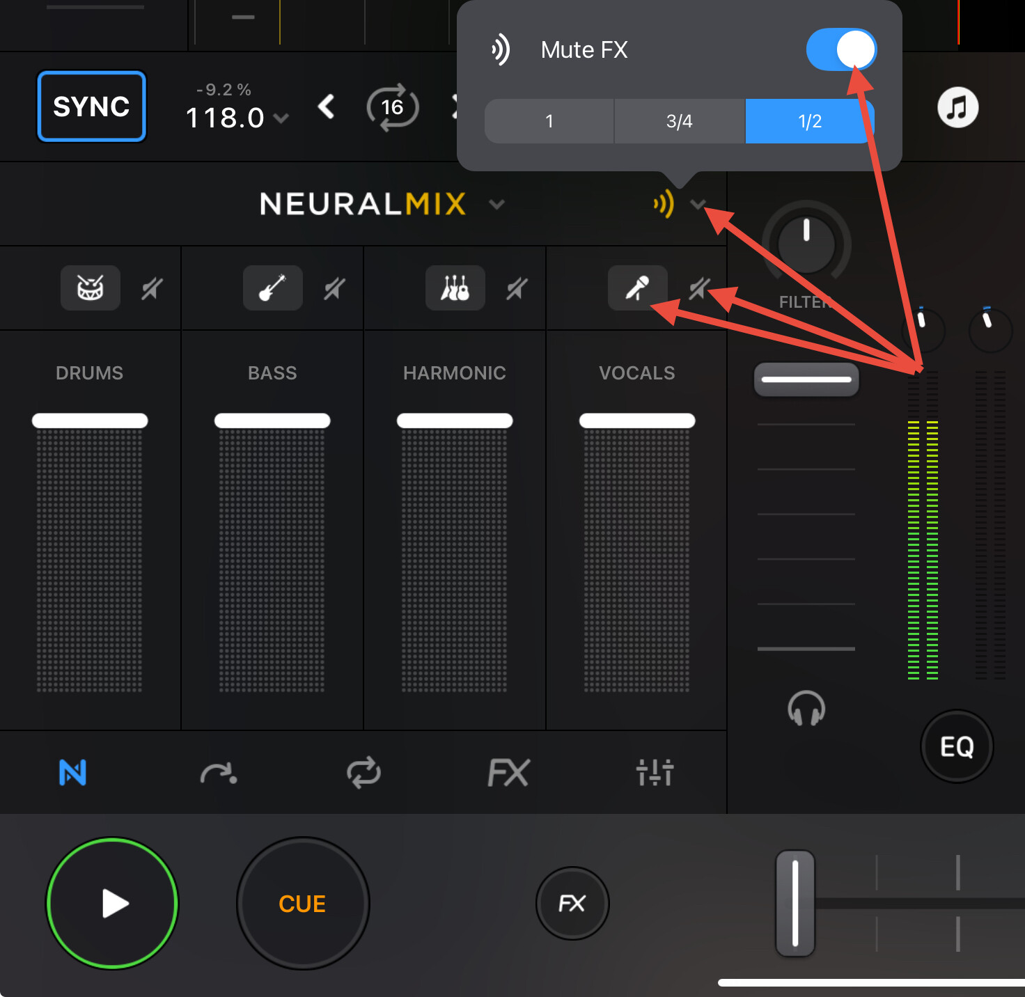

Hello everyone, I just wanted to let you know that you can now achieve a similar effect, but with a slightly different workflow using the new Neural Mix Mute FX.
  1. First you need to enable this in the Neural Mix Tools panel.
  2. Now, instead of trying to apply an Echo Out FX on the Vocal STEM, you use the Vocal Mute or Vocal Solo (depending on your preference). Here’s a short demo using the Vocal Mute.
I hope that helps!
