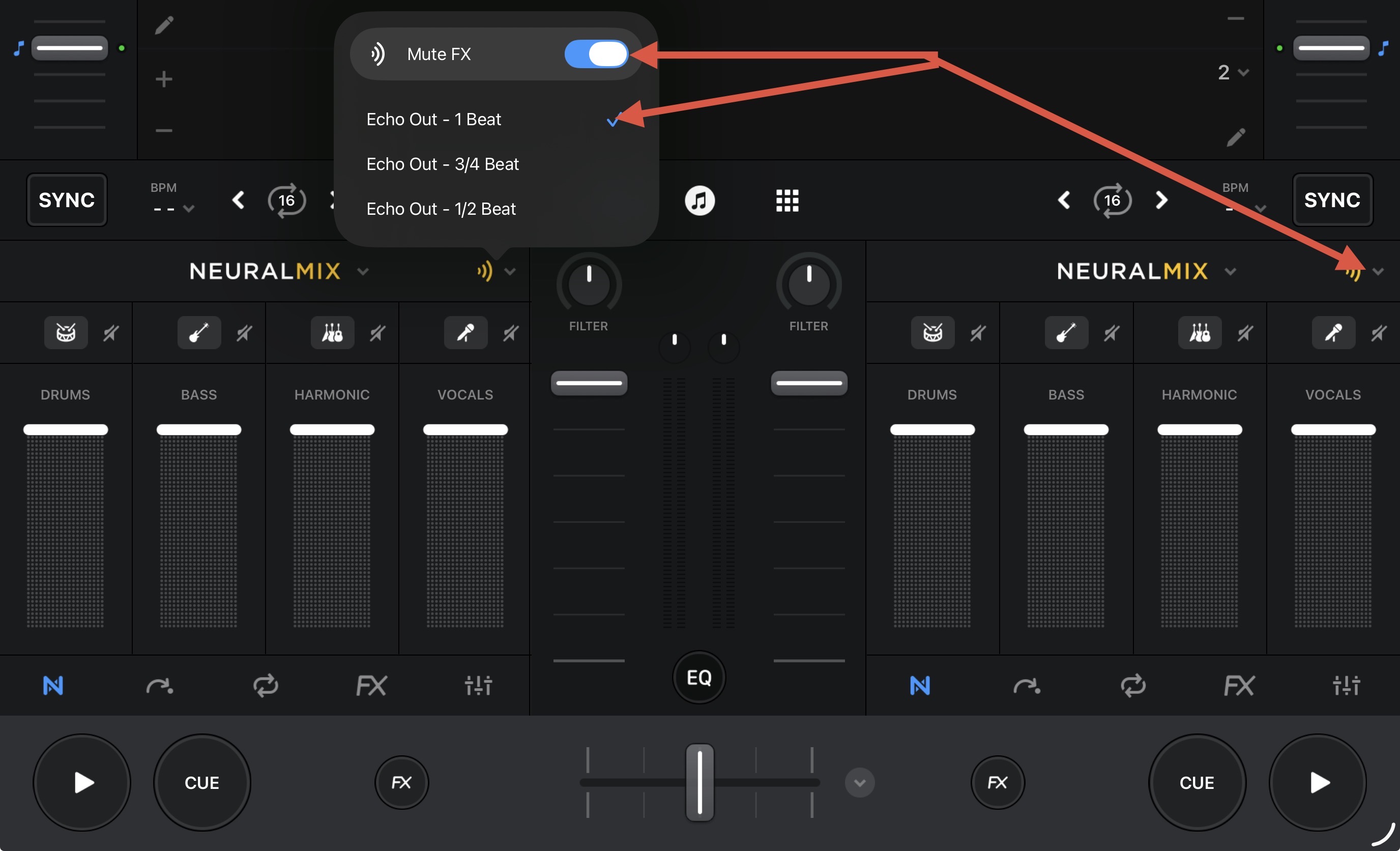

Hi @VNAelectro, I’ve merged your new topic with this exiting one as they are closely related. Please note that everything related to Neural Mix is processed last in the audio chain. This is currently expected behaviour. However, there is a newer feature in djay called Mute FX which might help in your use case.

You’re right this could be a work around since my main use is during the transition between 2 tracks where I keep the accapella on the finishing track and would like the echo tail to remain when I stop the track.
I will rethink my controller mapping :grin:
