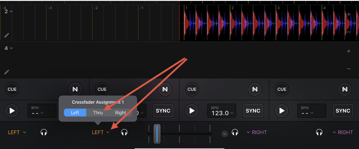

  1. Switch to 4 Deck Mode and set the Crossfader Assignment for each Deck to Thru.

Switch to 4 Deck Mode and set the Crossfader Assignment for each Deck to Thru. –> This works, but this isn’t a solution for me, because you have to do this every time you start the App.
