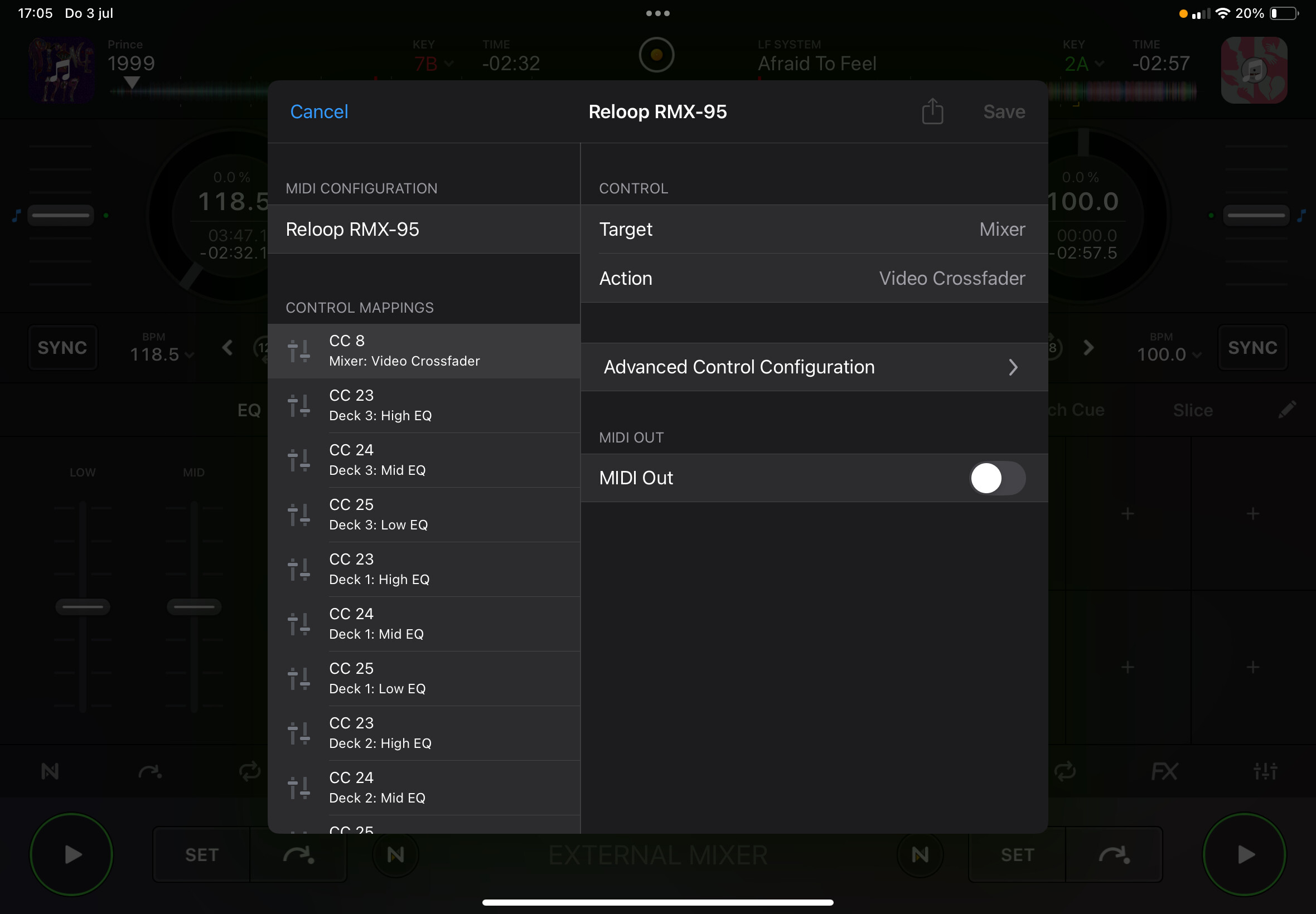

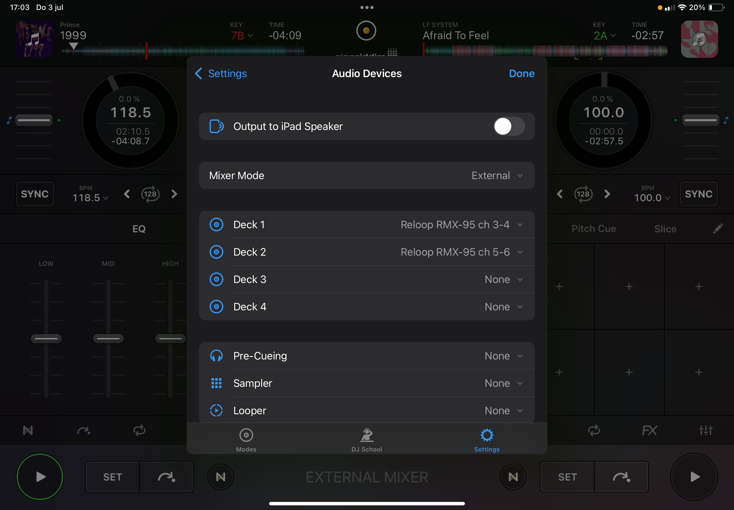

Regarding the Crossfader, with the RMX connected to you iPad, can you please share some screenshots of your Audio Devices and MIDI Devices settings?
Also, are you using the (build in) MIDI mapping or a customer edit?

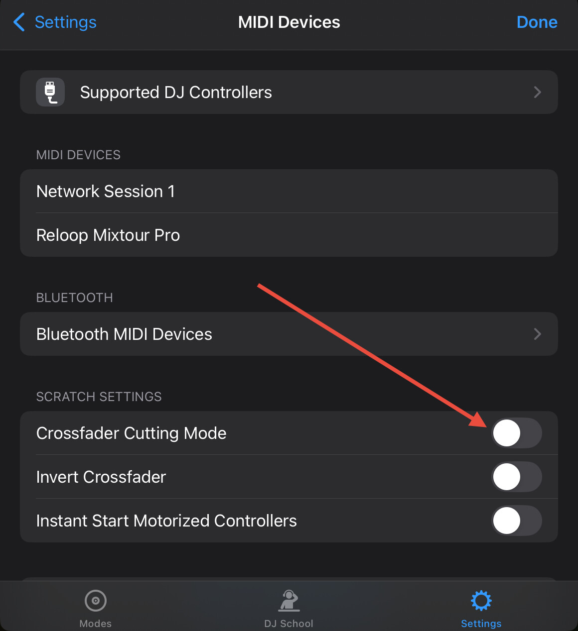

  1. Can you please scroll down in the Audio Devices and select Reset to Defaults
  2. What is your Crossfader Curve setting in Settings>Sound
  3. Also, in the MIDI Devices page, make sure Crossfader Cutting Mode is disabled.

  3. Crossfader cutting mode was already disabled.

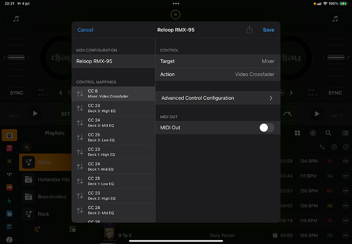

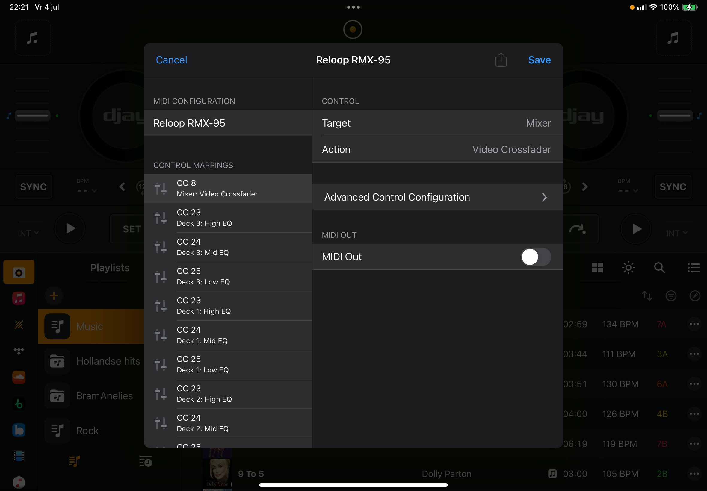

After rebooting, please open the MIDI Learn tool within djay then move the Crossfader and share a screenshot of the mapping.
@Swamp are you using the (built-in) MIDI mapping or an edited version?
The Built-in version
