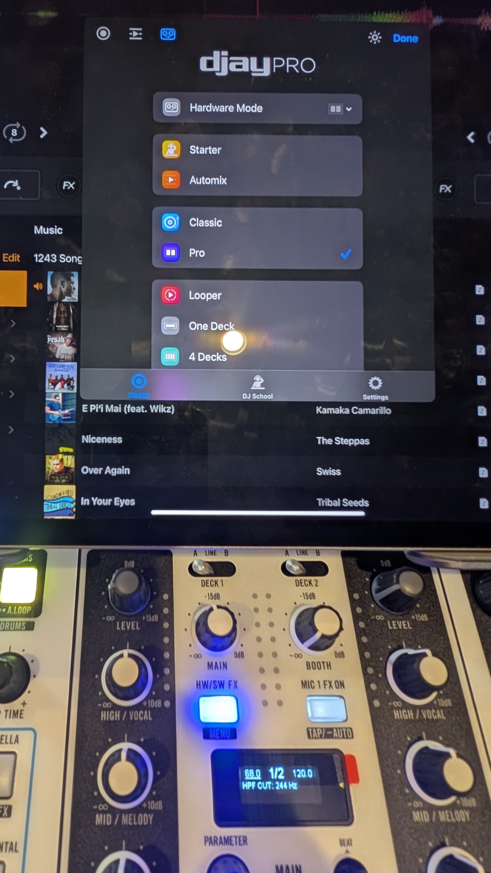

When set to Pro mode, Rane MK2 says it’s an external mixer. My understanding is when a controller is connected, it wouldn’t say it’s an external mixer (only other mixers like an s11 or reloop elite, etc.
Hi @d.Jaebren, the RANE One is an External Mixer Mode device so this is expected behaviour. This is pretty common for larger controllers like this, the RANE Four, the RANE Performer, Pioneer XDJ-RX3, Pioneer REV7, etc..
Yes as expected as the Rane Mk2 can also be used as a standalone mixer with use of hardware effects if required.

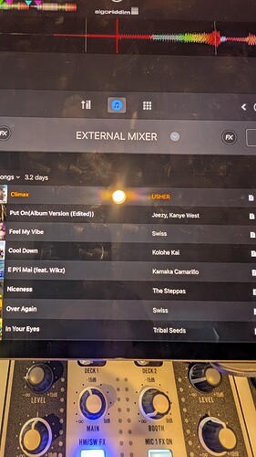

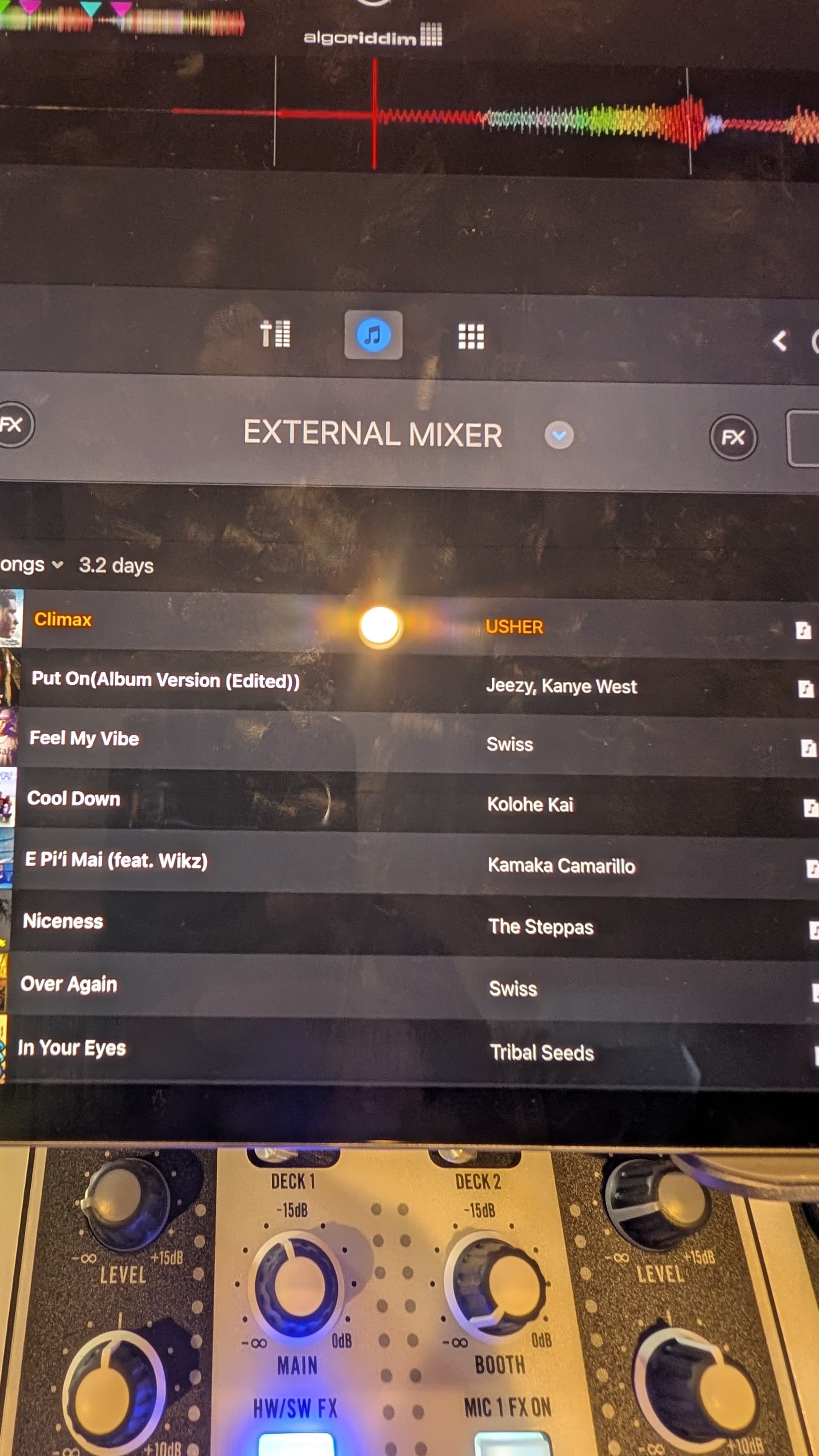

Hi,
I’m using the Rane One MKII with the iPad Pro M4, and I can’t preview a track from a playlist. Nothing is playing on the headphones. I always have to drag the track to a deck first. Can anyone help me? Do I need to configure a specific setting? :grimacing:
Thanks
The faders might not connect to the UI because I assume the mkII is used in external mixer mode. Not sure what the default mode is for the og.
