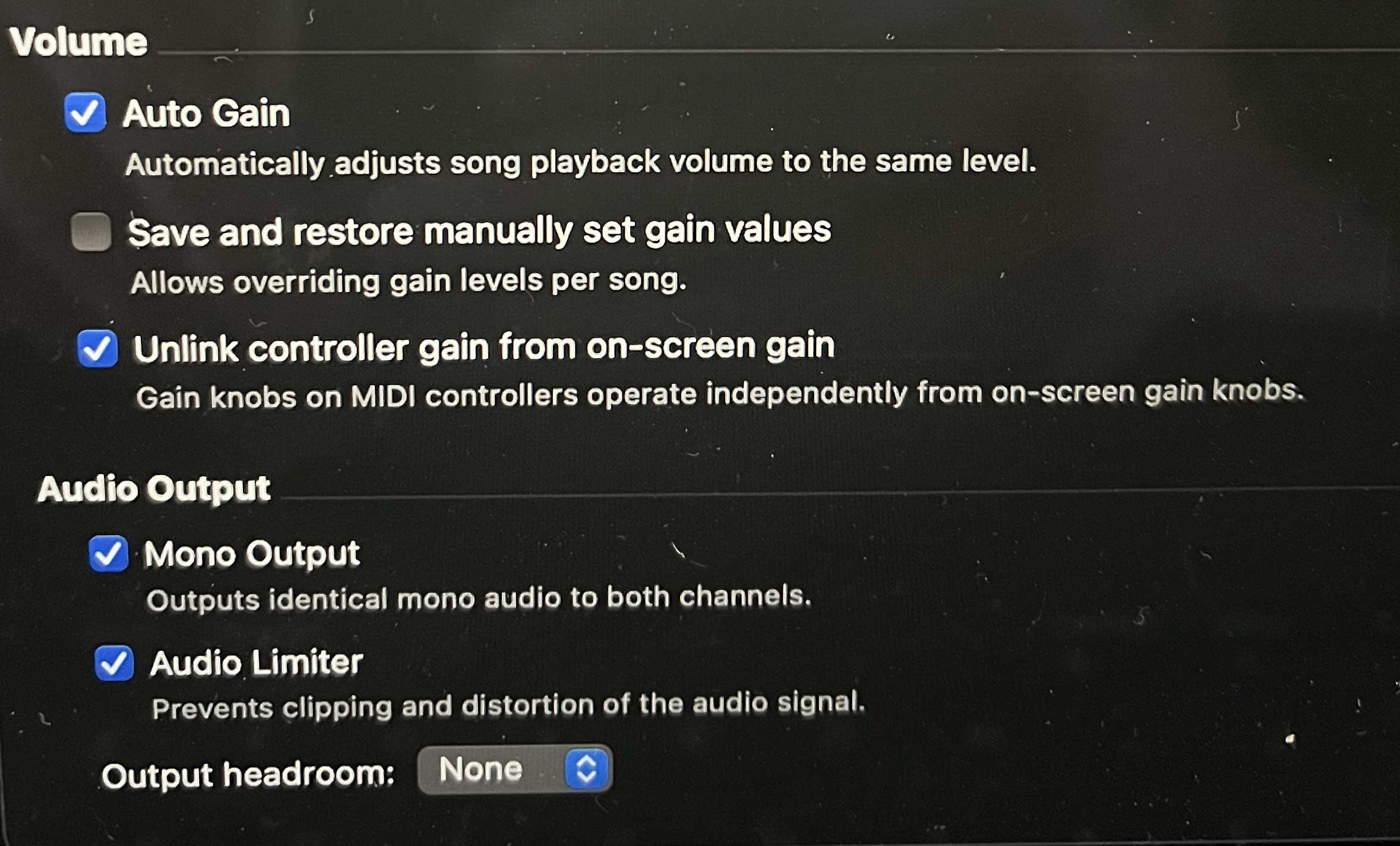

Hi @Len91, thanks for the feedback. Regarding the lower volume on the right deck, can you please share a screenshot of your djay Settings>Sound? In particular, I’d like to know what your Gain Settings and Headroom Settings are. Thanks!
Thanks for the screenshot @Len91. Can you please try to capture a short video of this “lower volume on right deck” issue? Thanks!
