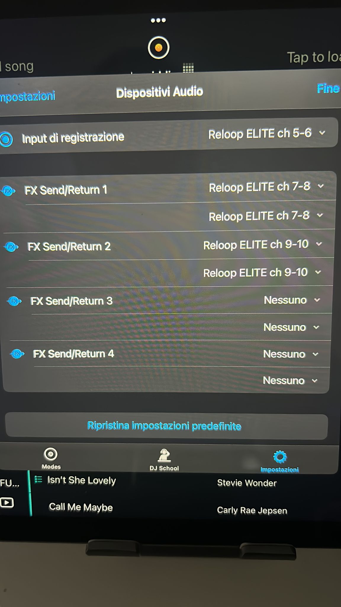

HI GUYS ,
follow my elite set up like external mixer using all the usb channel. NB not need an usb channel for pre cueing in external mixer mode
