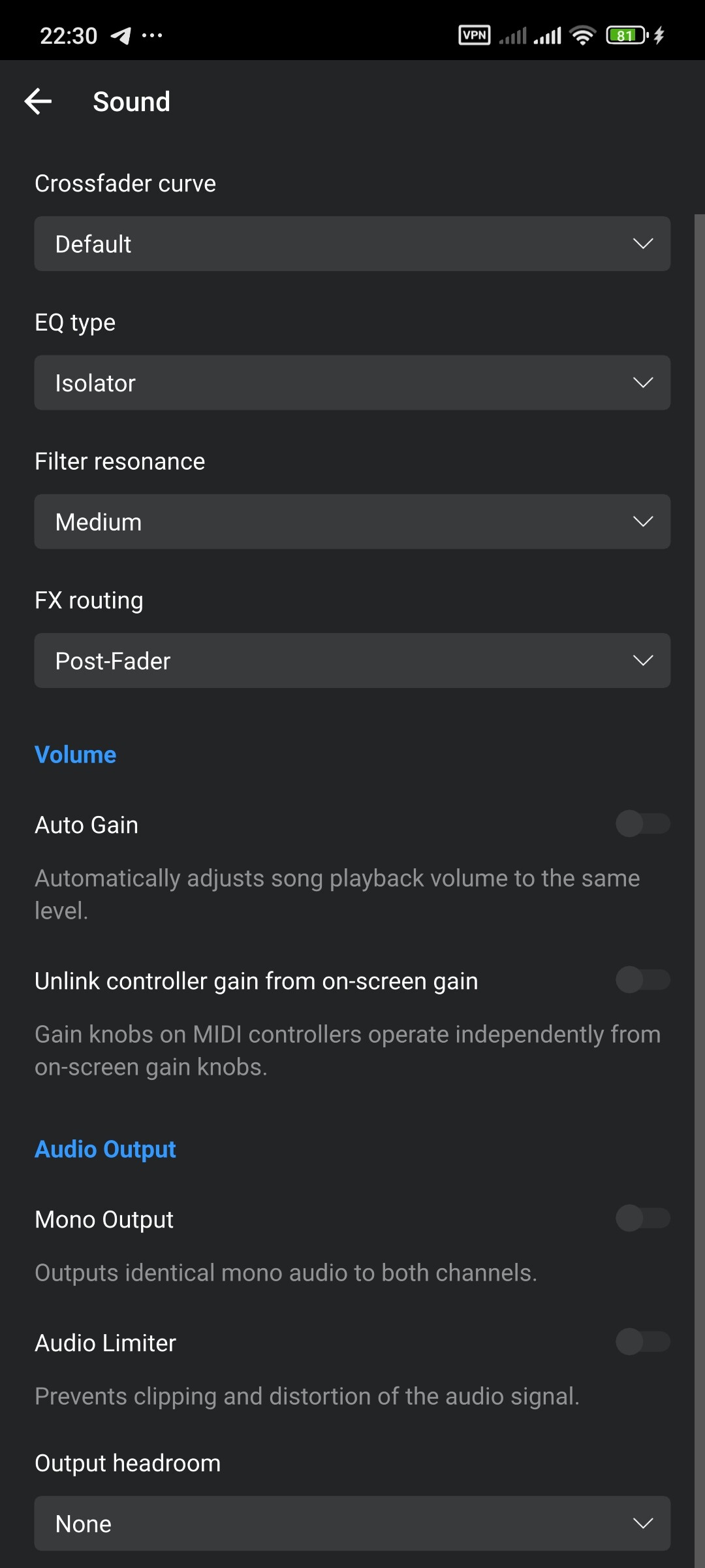

  2. Please share screenshots of your djay Settings>Sound.
The controller is in stereo mode. in mono mode, there is only sound, the buttons stop working.
Thanks @_360. Please try enabling the Mono Output in the Sound Settings while keeping the Mixtour Pro hardware switch in Stereo.
It doesn’t help.

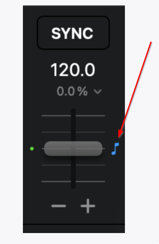

Also, can you please try turning Key Lock Off on both decks to see if that helps with the audio issue? Select the musical next to the Tempo Fader so that is changes from Blue (On) to White (Off)

disabling the key lock does not solve the problem.
