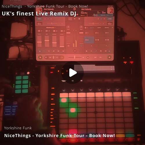

My idea is; use the pads and sequencer to create ‘reinforcement’ drums patterns in cue, then bring up levels to match the tunes playing. I would like to use the Looper but it seems you can’t have user-created loops, and you can’t interchange the ones present…I don’t think there’s been any new one for a very long time?
Can I do this?
Here’s an example (but I’ll be using only a controller and less iPad)
P.S. I’m aware off midi mapping, but the DJ-505 isn’t class complaint, so looking at similar, or better, specifically for Sampler and Looper functionality.
