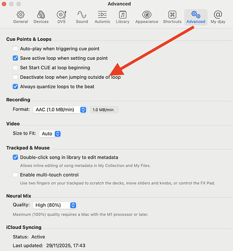

I’m honesty confused: say I have a saved loop at the start of the track and it’s not active. There’s also a hot cue on it. When I reach a later part of the track I’d like to jump back to the saved loops and have it activated. The hardware only activate the loop, but not jump to it. So when I turn it on, and next I press the hot cue of the loop, the playhead jumps to the cue but deactivate the loop?! What’s the point of having a saved loops if that’s how it works? Or did I get it all wrong?

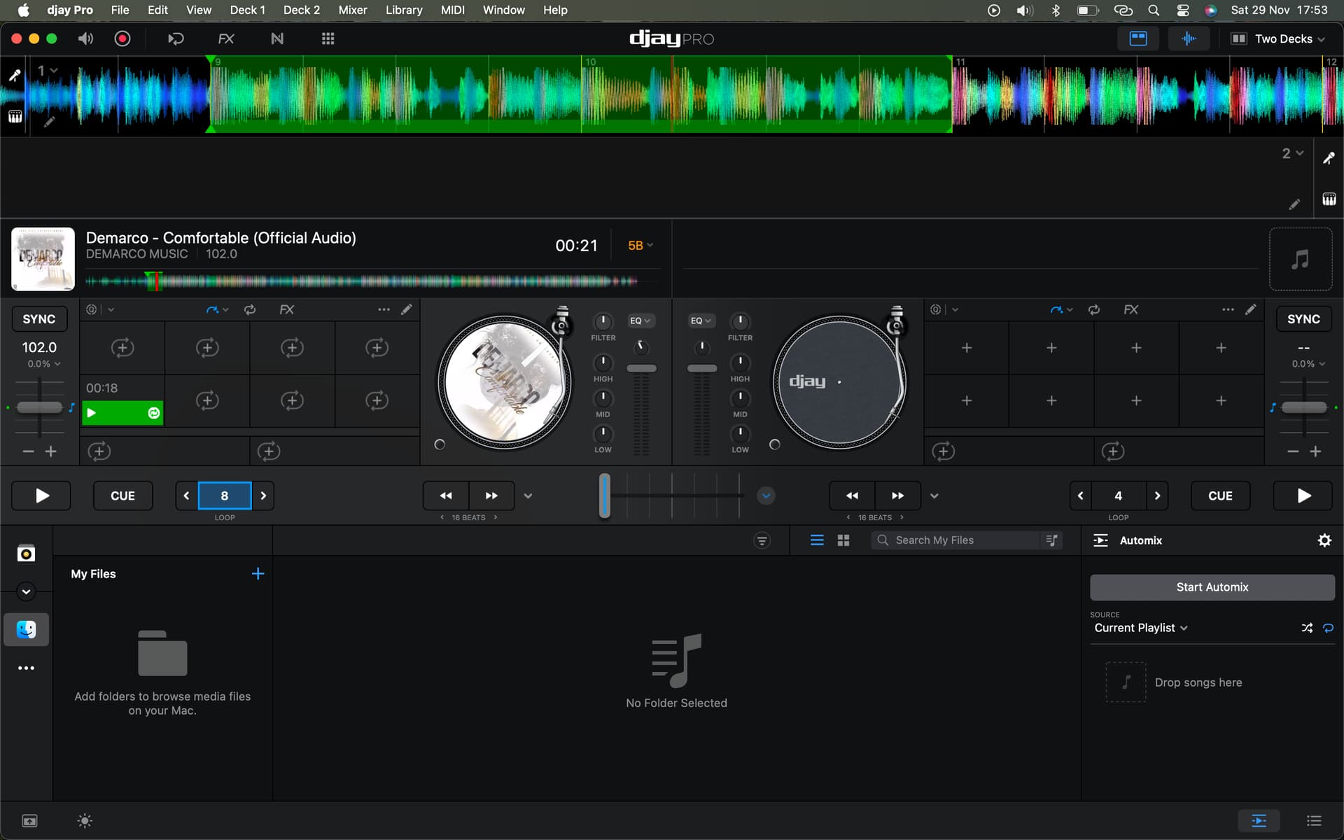

Turn your hotcue and saved loop into a Cue Loop, in that case, as soon as you hit the hotcue, the loop is activated automatically.
How to do this??
Delete the hotcue, activate the loop and while it is playing, create a hotcue again. This hotcue will be a Cue Loop (you will see the looped portion of waveform highlighted with eh cue color like this
