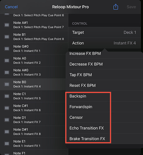

Can I customize the second layer of Pad FX in Djay pro via software settings (like the first layer) or do I have to do it via midi mapping? (in rekordbox you can customize but I couldn’t find a way to do that in djaypro, too). On the controller, you get there with SHIFT PAD FX 1/2, on the software the first layer is displayed at FX → INSTANT
Hi @turbopussy, this needs to be done via MIDI mapping.
Ok, but how do I see then which buttons have been customized with which effects? Or how do I see which effects are currently assigned?

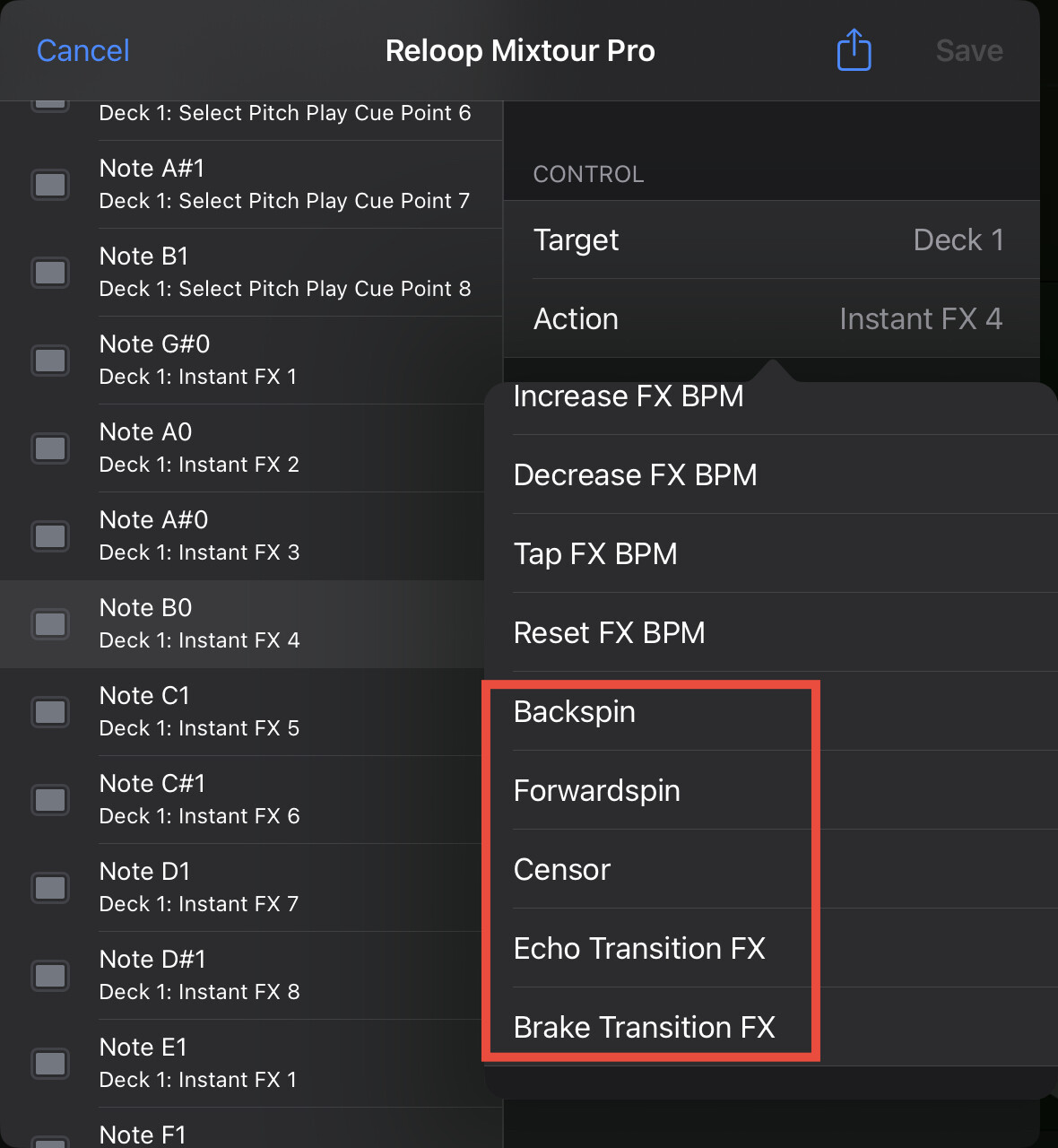

Hi @turbopussy, to clarify, djay currently only supports 8 Instant FX per deck. So, you cannot for example add another bank of 8 different Instant FX to another Pad Mode. There is, however, a small selection of extra FX that you could map to individual buttons of your second Pad Mode layer. These include Backspin, Forwardspin, Censor, Echo Transition FX and Brake Transition FX.
If you’d like more info on how to MIDI map on iOS, please refer to the linked FAQ below.
https://help.algoriddim.com/hc/en-us/articles/360016055199-How-do-I-MIDI-map-a-controller-on-djay-for-iOS
