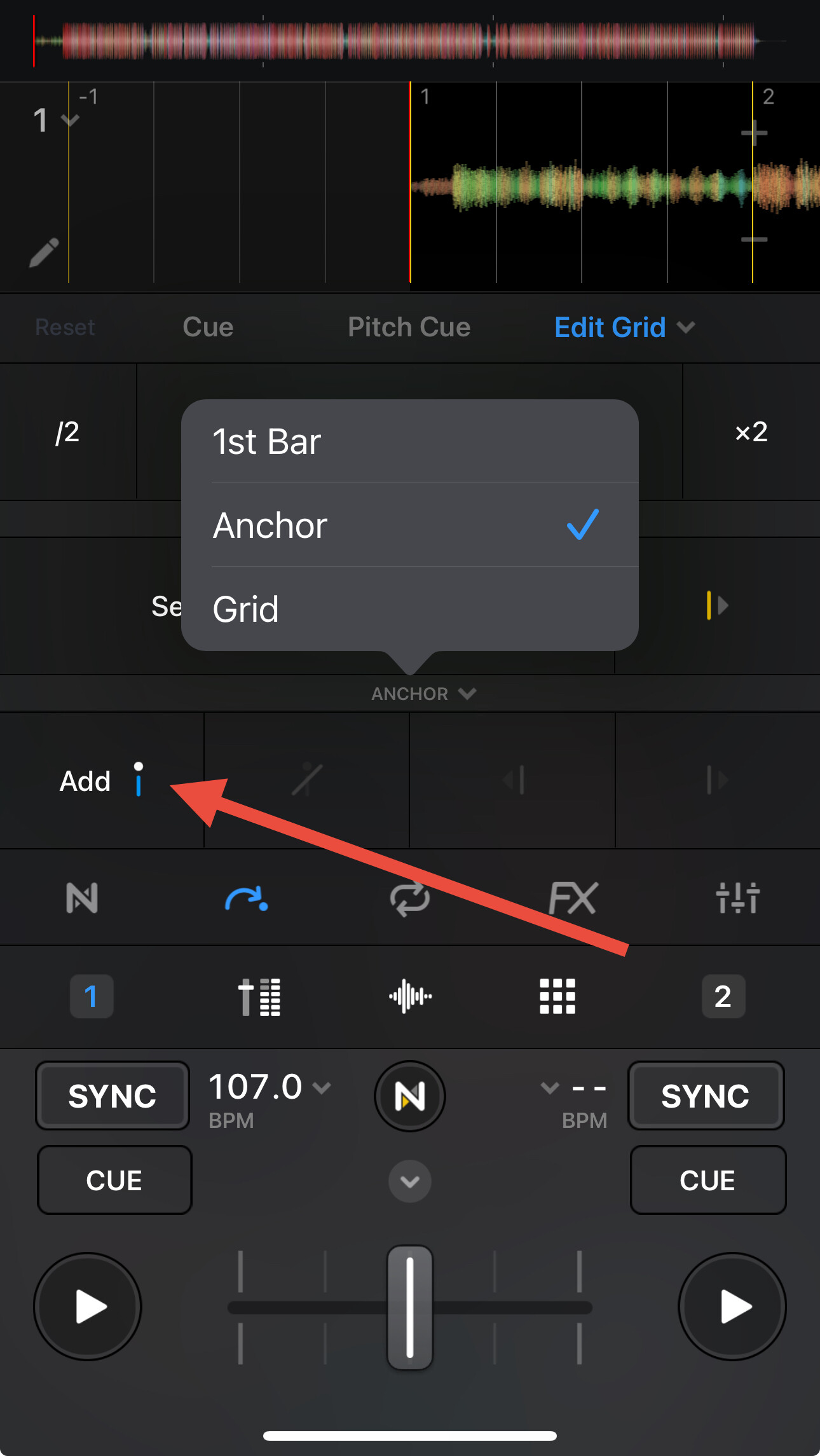

Hi @N_C, djay’s Fluid Beatgrid system should be able to handle this automatically. If the system doesn’t get it perfect, you can just drop manual Anchor Points to make adjustments. Neural Mix Pro also has the Fluid Beatgrid system.

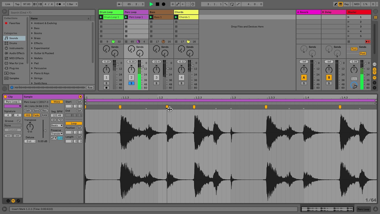

You can do this with Ableton Live using the Warp function.
Thanks, I took another look at Abelton, but it’s too fiddly, much like GarageBand, I need something that automates it, like Djay does, but I need to be able to export it. You should add this neural mix pro.

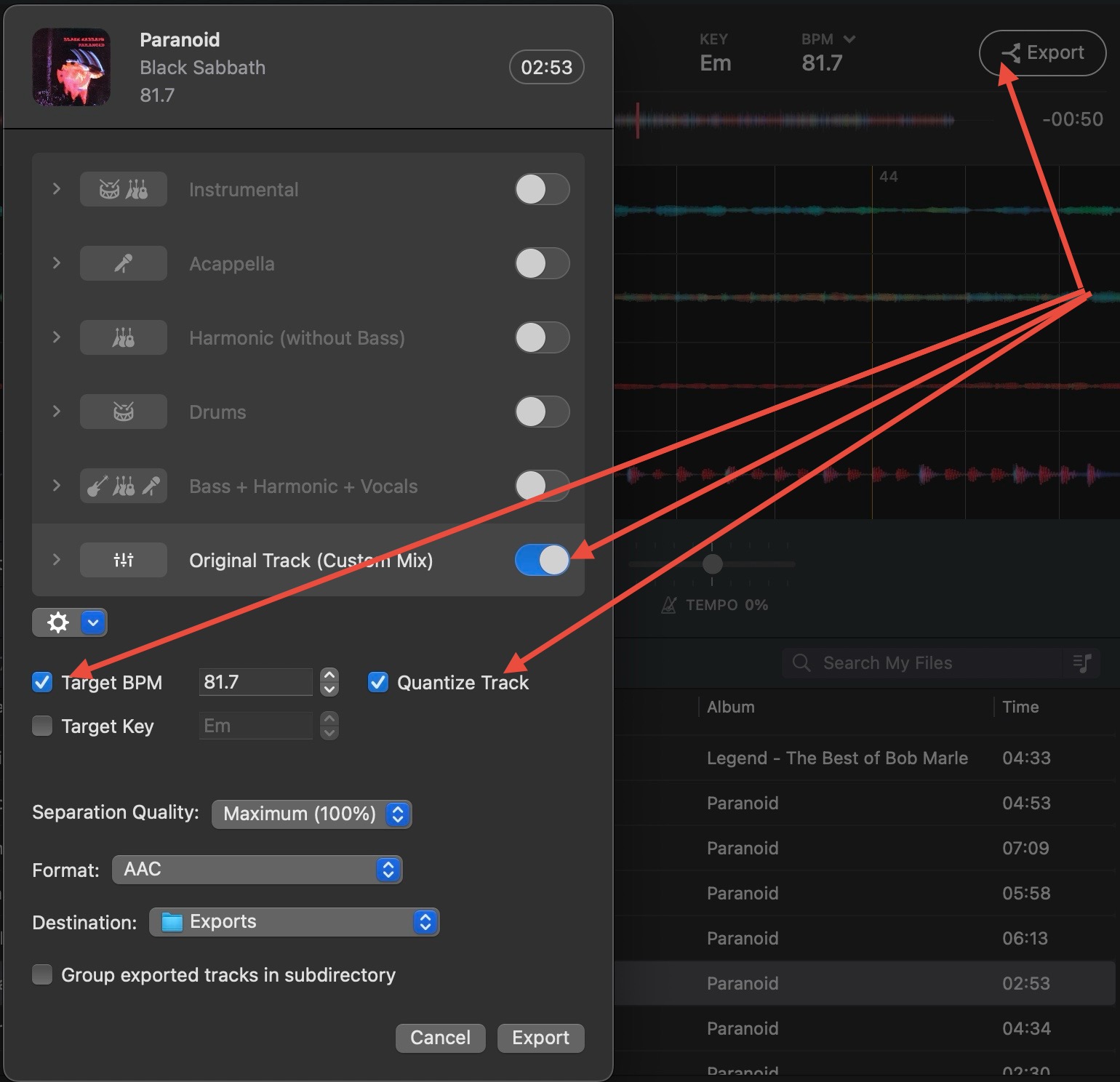

Hi @N_C, yes, the stand alone Neural Mix Pro 2.0 software on macOS can export the corrected tracks. Please note that Neural Mix Pro and djay Pro are separate apps.

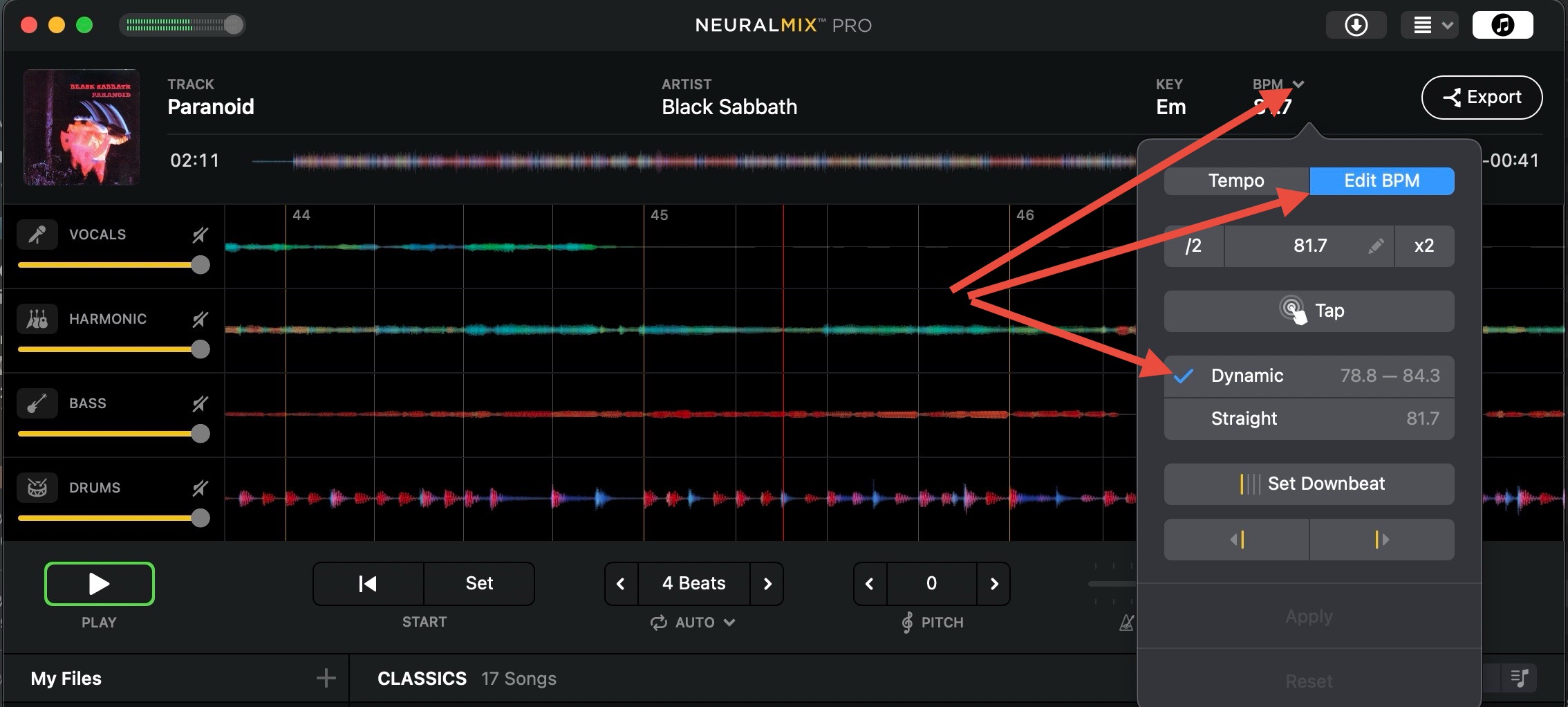

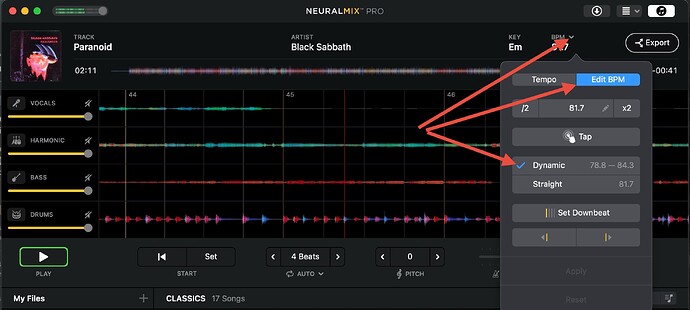

@N_C please see example below
Ok thanks, so you have a track that fluctuates between 124.50 and 125.50, you set as dynamic, then export at target 125 with Quantize on right? This works without separation? So apart from tempo adjust I’ll get the track back exactly, sonically as I imported?
You’re welcome @N_C. Yes, that is correct.
Cool. I can’t export on the trial though right, so I have to buy it to see if this works.

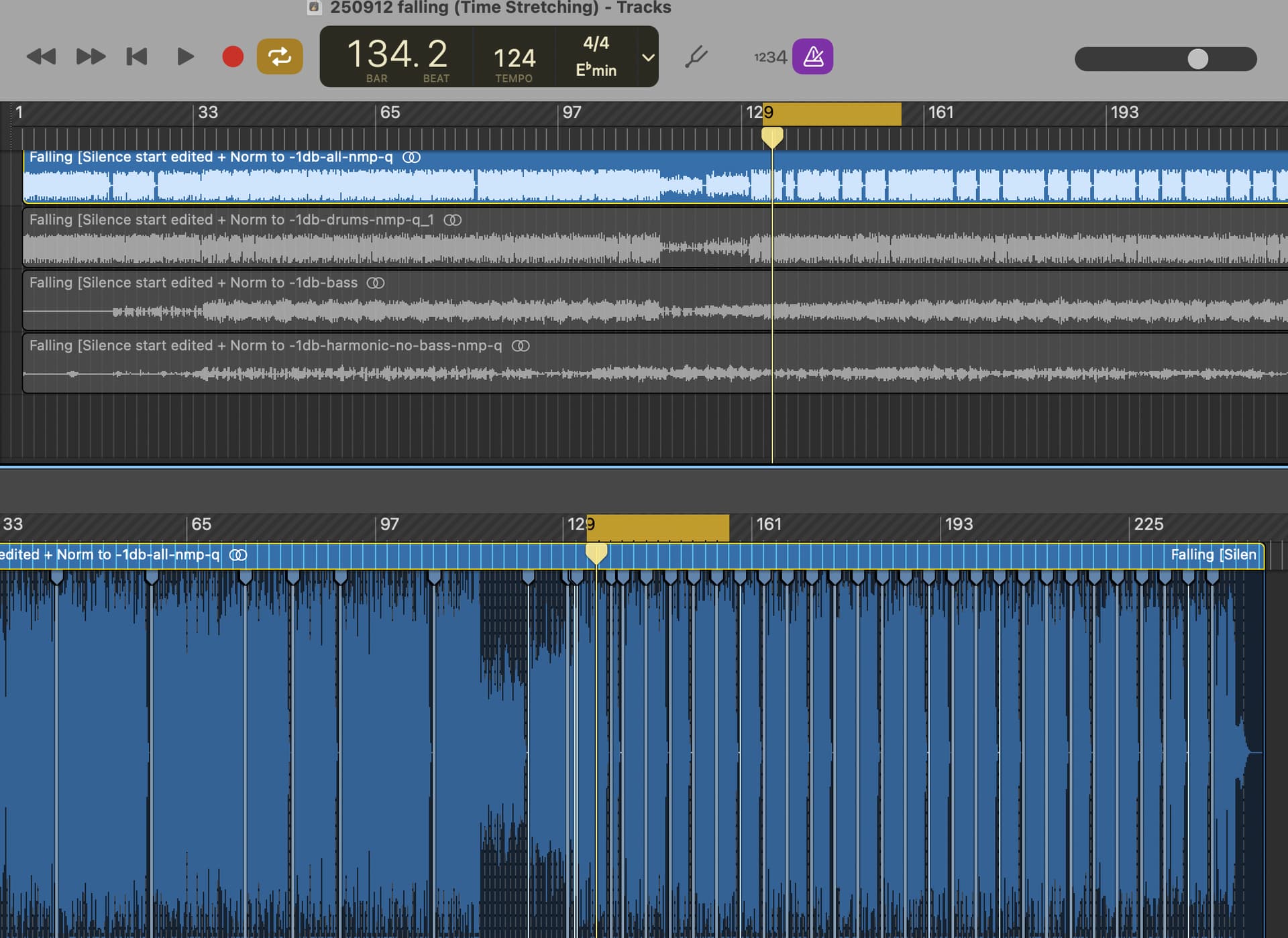

Ok, so the jury is out on this. basically concerning this one specific track (I honestly haven’t had time to check others), I’ve ended up doing manual adjustments post NMP quantising, which defeats the object. However I’m open to the possibility that “it’s me, not you”. Maybe results aren’t expected to be perfect, maybe I’m over analysing, maybe this track is difficult to read as a waveform (the kick is not very clear tbh) - I don’t know. So if at all possible, I think the best thing is for me to send over the specific track and to get someone else’s opinion. Attached Mp3 is pre-quantising. Screenshot shows manual adjustments made to post quantised version.
Hi @N_C, regarding your question of what is technically going on under the hood, I don’t have anything that I can share with you there. As for this particular track, I had a quick look in NMP on my setup and it seems to have done a good job of quantizing to me. However, I have shared this track with our engineering team for further analysis. Please note that the specific engineer for Fluid Beatgrids is away on vacation at the moment though. I’ll report back when I hear back. Thanks!
Hi again @N_C, our engineer also looked at your file. This track seems completely straight (quantized) and gets analyzed accordingly, so we’re not sure what you are experiencing/expecting here. Perhaps you could also share your exported quantized/warped version, so we can better understand what you mean? Thanks!
