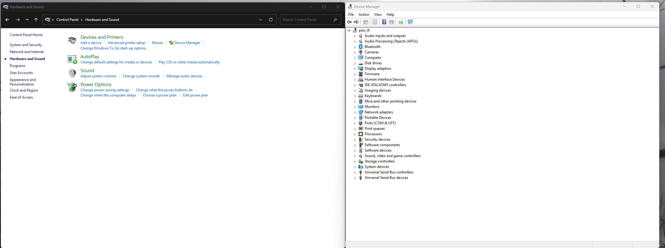

As you updated your Windows, most probably you need to uinstall the “old” FLX4 from devices.
Control Panel → Device Manager.
It’s somewhere there
Then shutdown computer, connect your flx4, restart.
Then the windows should recognize new device and install correct drivers.
