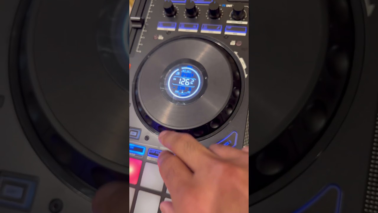

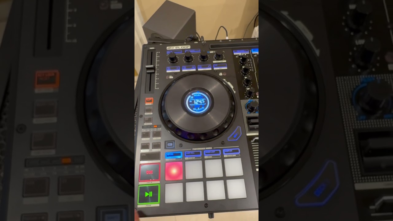

I am now on my second Mixon Pro 8. Initial one had issues with the volume output levels and rare jogwheel sticking. I returned that unit to a reseller and just received my second unit from a different reseller.
This second unit is much much worse. The unit came with firmware 3224. I updated firmware twice straight out of the box and tried with both MacBook and iOS djay. Both had major issues with left jog wheel sticking and occasionally stopping play all together (despite green light solid.) I tried with serato dj pro and same issue so definitely seems like a hardware issue.
I’ve uploaded videos below.
Reloop really needs to answer for how they can have SO MANY defective units. Really a bad look. Where is the quality control? I want to like it so bad
Seems similar to my sticking wheel and another user wheel tracking issue that doesn’t play. Seems like hardware issue.

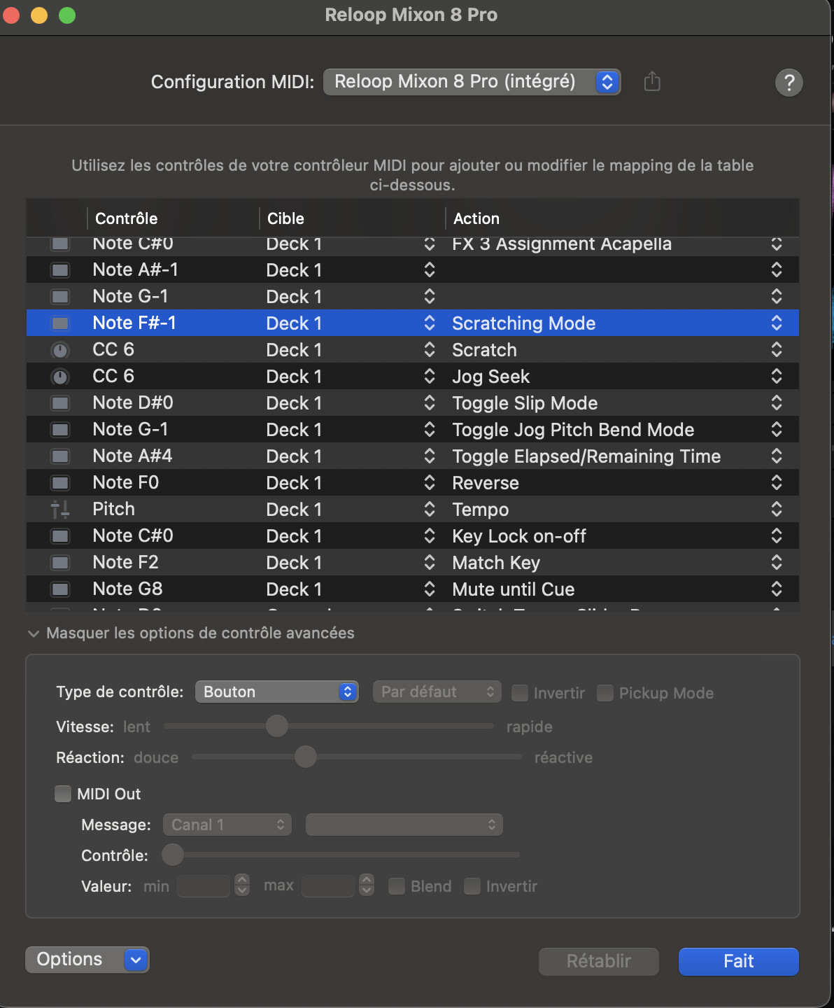

I don’t have the Mixon 8, but had similar issues with custom mapping my midi fighter twister controller. At random moments, but usually twice during a 2 hr set, scratching stopped working and also start track would have no effect, green light but no real start. I could start the track by touching / moving the waveform with the mouse on the UI. With this I could continue the set. I then had to disconnect and reconnect the controller to get the controls from the controller working again.
There are two possible scratch mappings, scratch (no touch detection) and plain scratch. Trying to be clever, I initially used the no touch detection option, but it looks like the normal plain scratch mapping works better in this regard, you just can’t scratch a running track that way with a control without touch. But I don’t care.

To Mixon 8 users, can you find what mapping is used? ‘scratch without touch detection’ or ‘scratch’? If it is the first, map it to the latter, maybe less problems, unfortunately also less functionality. Would be interesting to know if this is the case, since this might be the key to a solution.
Edit: Removed an outing of frustration. :sunglasses:
Edit: Here it was shown it is ‘scratch’. Anyway, it still looks like an ordinary timing issue that is easy to solve if companies work together
