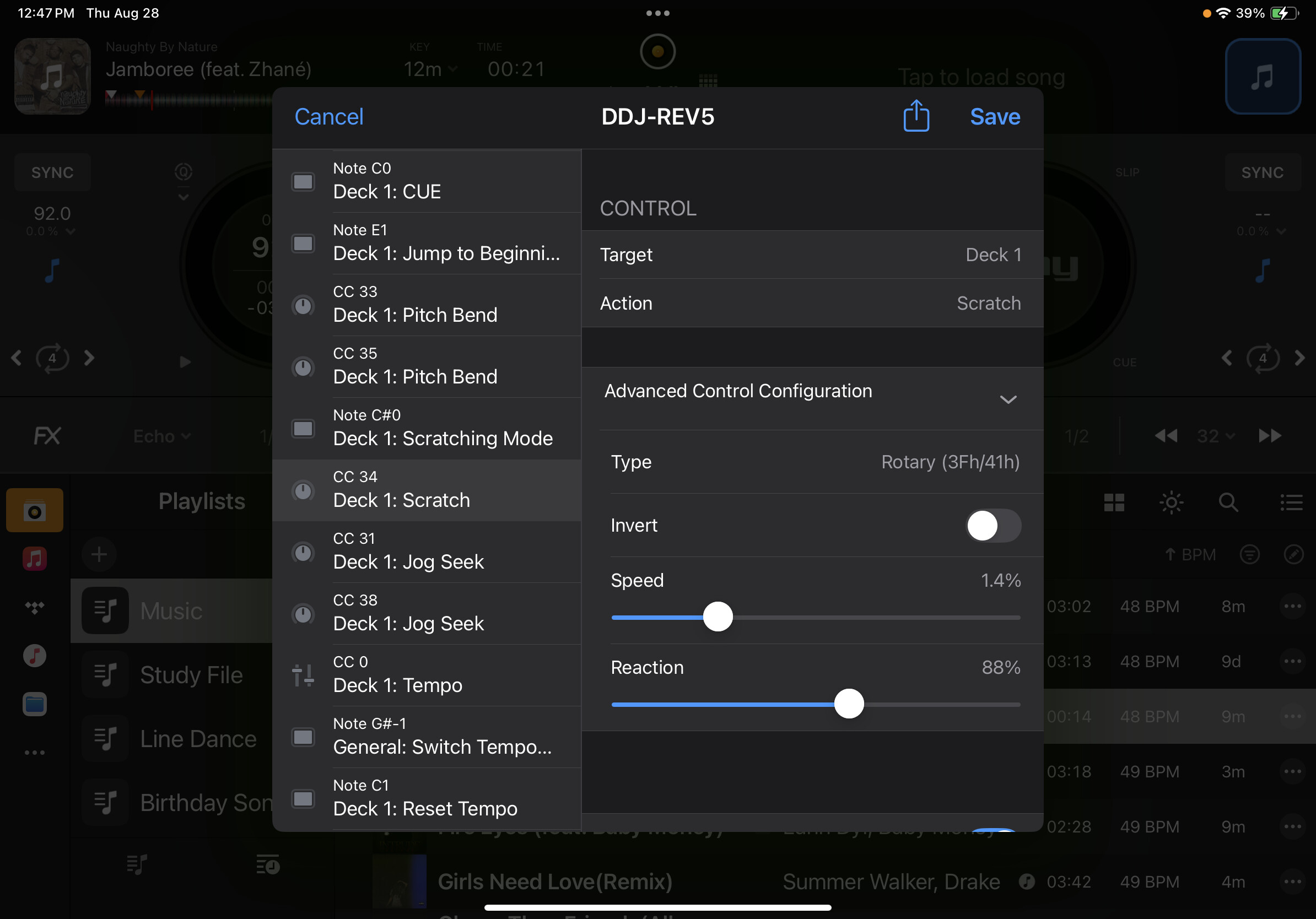

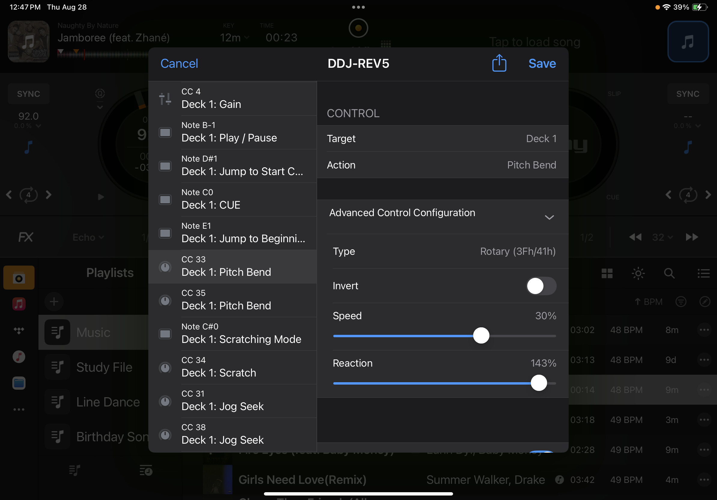

I changed the reactivity to my taste (150%)…
Thanks gonna try that
The Rev 1 is still way better than the Rev 5’s jog wheel response. Actually the Rev 1 and the flx10 jog response are about the same. Hopefully they keep working on it. No setting helped me…. So just baby scrathes when using the Rev 5 with djay

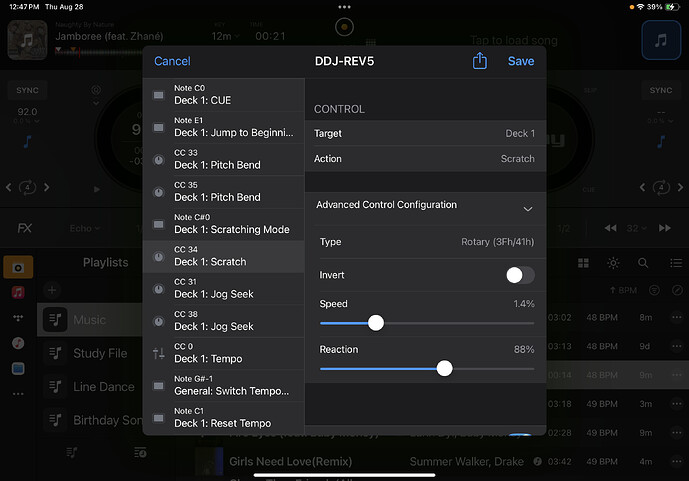

Been testing setting on the jog wheels…. Seems almost impossible for users to get close to Serato without some type of new midi functionality. The pitch bend plays an important part of what needs to be adjusted to accomplish perfect scratching. Maybe the support team can look at these settings and helps us out.
