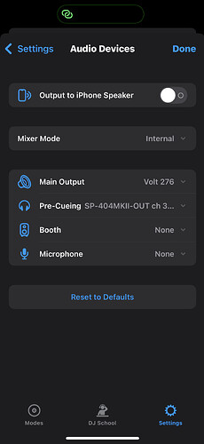

a few days ago my friend updated his phone to iOS 26 and we succeed at using multiple audio interfaces at once to output pre cue to one interface and master to the other. but what blows my mind that after updating my iPad to latest beta build I found out that this doesn’t work, BUT everything frikin just works on my iphone 15 on 18.5 and I would be glad if somebody could make sense of this cause my brain hurts
I’ve seen this happen before. Not sure if it’s intentional in the new iOS version…
but this happens on iOS 18 to be clear. and that’s what makes me think it’s on the djay side that’s different
It’s not really Djay that can make that happen. It used to be an iOS limitation, and with a lot of fiddling I accidentally got it running. I doubt anything changed there…
Could you please confirm the stability if the setup with two audio interfaces running at the same time? Mine works fine on iPadOS 26 but I’m afraid to go live with this setup in front of a crowd
