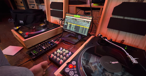

I’ve made a full view video of my entire setup and explanation with multiple examples. I hope this is logged as an official bug. I simply can’t use hot cue loops at the moment.

Here’s a YouTube link. Hopefully this one will work better. Freshly uploaded but should process to HD soon. https://youtu.be/ArT4mzOxdHM?si=d6eGSH2jJyE40RaF
Thanks for the YouTube link @Austinjacobm94. That worked. Perfect demonstration of the issue as well. I’ve passed this onto our engineering team for further analysis and will report back when I have news. Thanks again!
