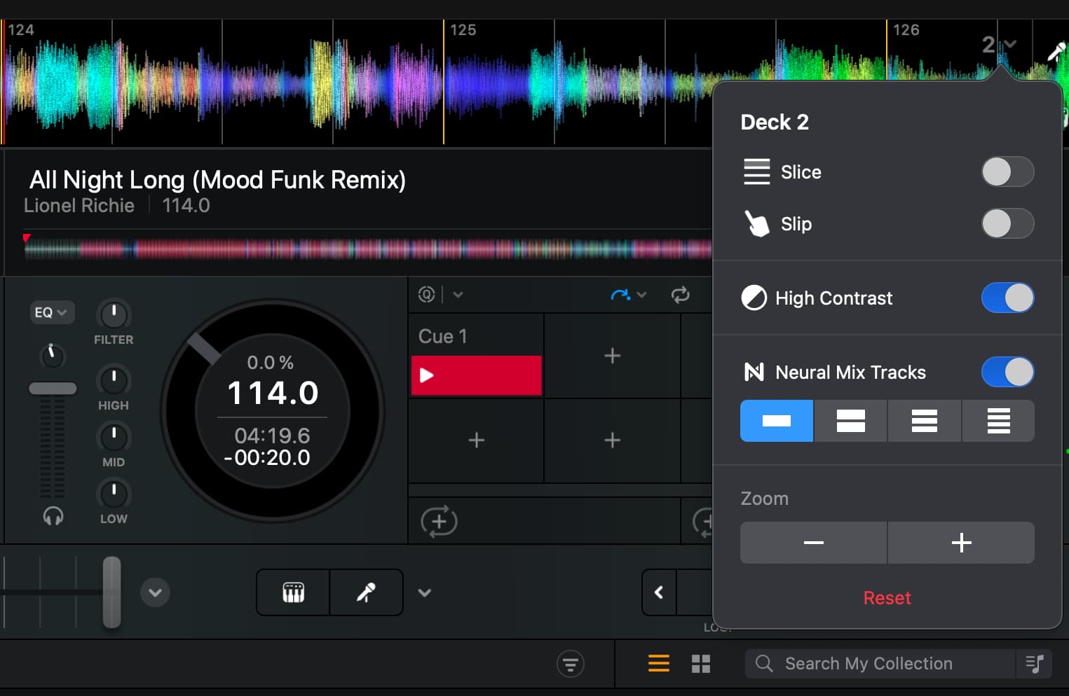

Enable Neural Mix Pre-Analysis when “1-Track NM Waveform” Option is Selected
Can the team make the 1-track option here force djay to analyze (calculate) neural mix on song load.
As of now, it’s only the 2,3 and 4 track option that actually analyzes neural mix and so avails it instantly when u need, albeit, it’s not very easy dj’ing with all those waveform tracks on screen.

Still following on the request/suggestion though - as my learned colleague suggested above, pre-analysis of stems using the referenced menu (neural mix track - 1 track menu to activate “anaylse stems on song load” in order to avail stems instantly when triggered

It is essentially the same as your request. Basically you want NM analysis to happen when the song loads. Currently that does happen if you use the 2, 3, or 4 Neural Mix waveform display. So also enabling this on the single waveform display would result in what you are after.
So, in the meantime, if you switch to one of the multi-waveform display options you will get NM analysis upon loading.

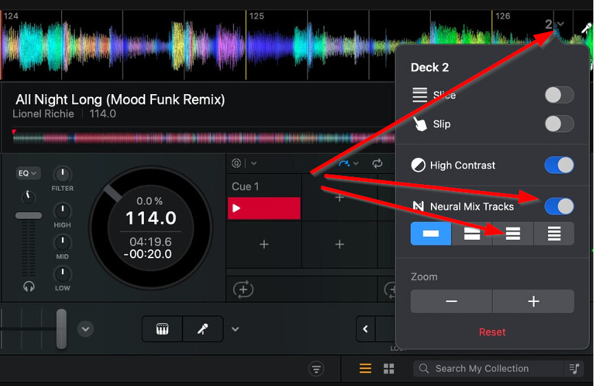

Yes we’re both asking the same thing, except mine here adds a ON/OFF switch to the function so that other times when we don’t want the software to analyse on song-loading, we can turn it off by unchecking arrow number 2 in screenshot (neural mix tracks off)
